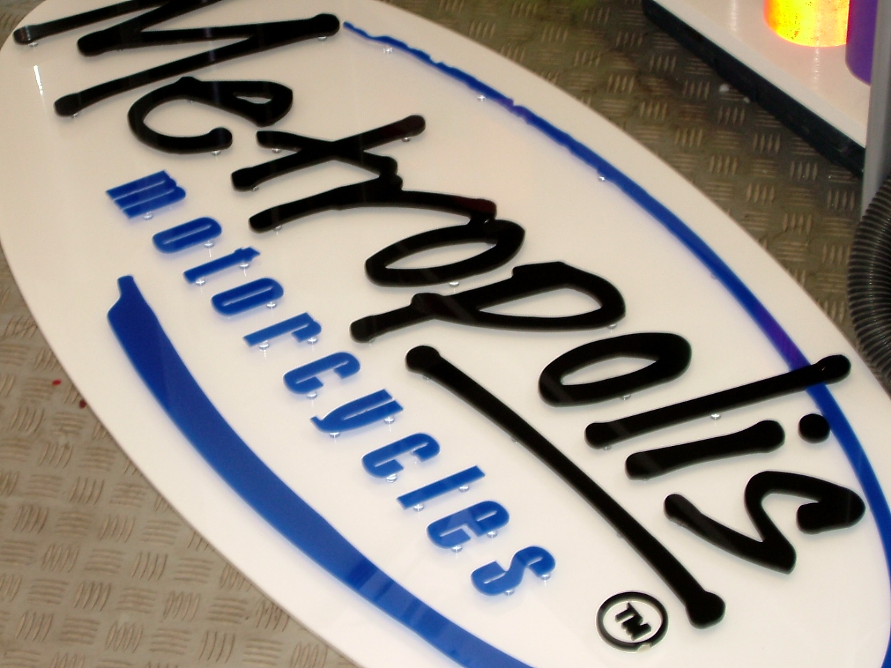

    hi all you may have read a post re this job

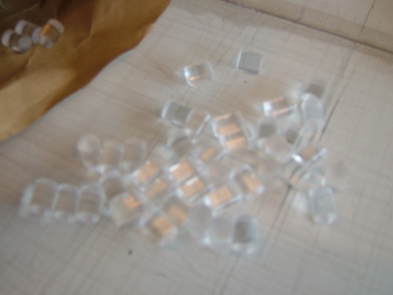

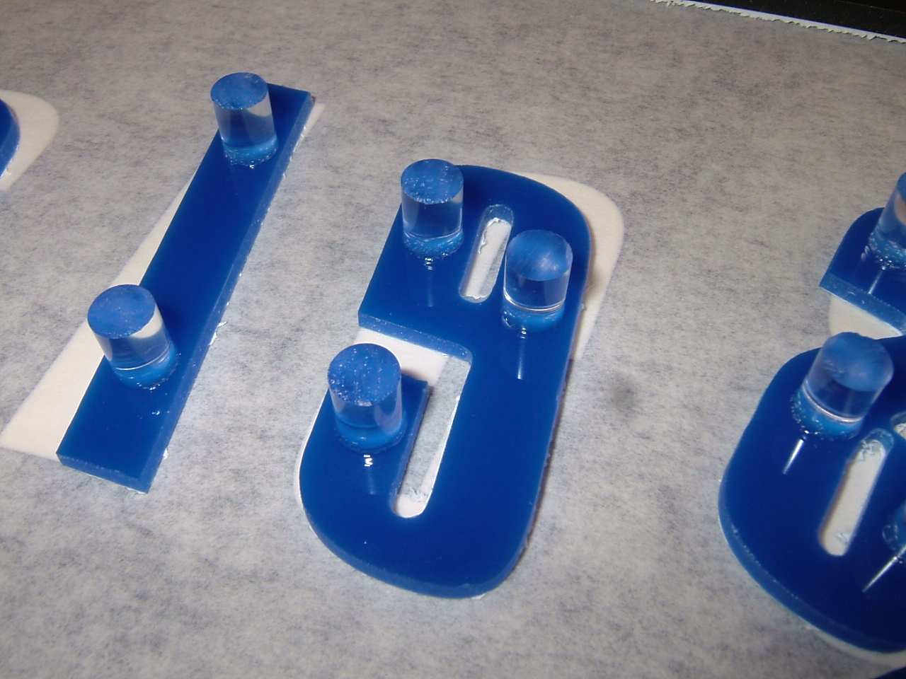

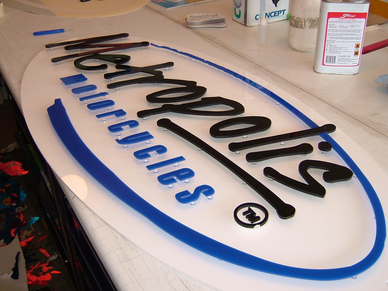

    i had to think of i nice way to mount this logo and came up with the idea of cutting 200 8mmx10mm clear acrylic rods mounting on letters then on to ovals
    had 2 of them to do one small and one larger
    hope you like rich
    thanks to mark from brimark signs for his help and advice
    and for a great job on time and price
    thanks mark

    Very nice Richard, good stuff. 😎

    Rich thats very nice, the clear spacers work really well.
    Brimark are very good, used them for a number of years now.

    i did think for a while we would not be able to have these on stand offs and i did ask a few suppliers to cut the 8mm bar but no one would i can understand why !!
    this sign would have looked so nasty with cups and locator’s

    we tend to have some clear poles of acrylic in stock just in case of emergency’s. we bought them from amari a good while back, we have a 1/4 inch length and a 3/4 inch length. comes in very hand for things like this.
