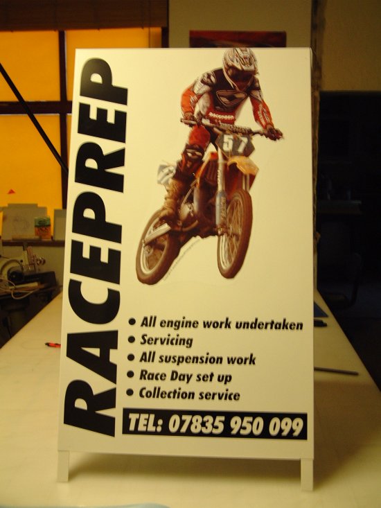

    Posted by Bill Dewison on January 13, 2005 at 4:01 pm
    Nothing special, just a A board with a PC60 print on it. The PC60 must be a sado masochist, its printing brilliantly again now after being slapped silly! I was amazed that following Chris’s advice on laying out the graphic differently saved so much in ribbons its unbelievable! Nice one Mr Sticker! 😀
    Cheers, Dewi

    Nice simple design mate 😀 Did you mean to cut the guys head off 😉

    Its just the orientation of the image on the printer Nik. With this image I tipped it upside down before it was printed, leaving a shorter distance to the edge of the print than if I’d printed it the other way up (as is default when you go to print). Basically just moving the image round to make the shortest distance from the starting point (when the ribbon touches the vinyl) to the finish point (when there is no more image to print in that pass).
    I s’pose its all common sense really, but because I lack it, I found it helpful to know 😀 Certainly saves alot of ribbon!
    Cheers, Dewi
    Edit: Sorry Nigel, I missed your post 😳 I got a CD full of photographs from the customer, and this one was the best I think, so I minused the background. Unfortunately the top of the helmet wasn’t in shot, but I think it sort of looks cool, like he’s wheelied off the sign or something :lol1:

    dewi… dead easy way around it, if i remember right….
    lets say you have an image 40 inches wide by 20inches deep.
    but you want to print it the width of machine…
    of course on the screen the image goes right off the page at one side by about 20inch…
    ok leave it like that…
    now just draw up a large white box and place it over the image where you want the machine to stop printing the tile…
    it cant print white so just stops and returns anyway…
    then when done move the unprinted bit onto print area and cover the other part with wite shape.. & repeat. 😉
