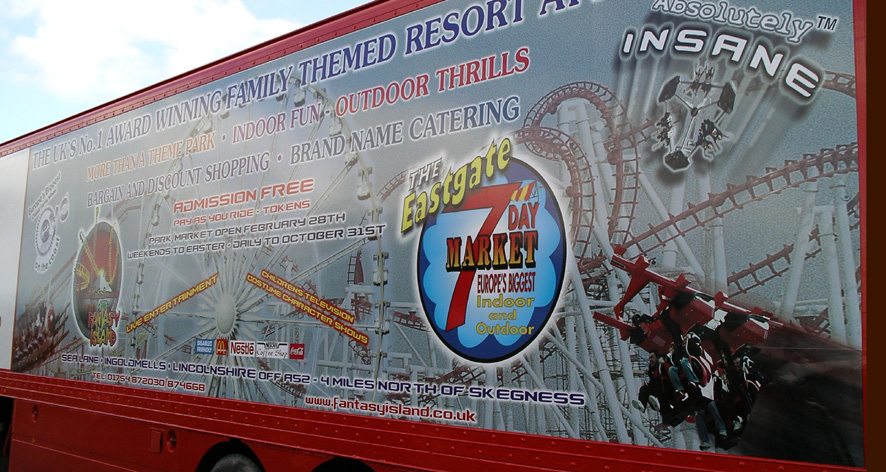

    This is my first attempt at anything of this size. I ventured into printing with the purhase of a Versacamm SP300 in Dec, my laminator turned up two days before this work began so my experience levels are low.
    I posted on this site and asked for help a couple of weeks ago, thankyou to all who responded. Your comments made me feel a little more at ease with the job.
    It all went smoothly and l can’t wait for the next one to come along!! Well my bank manager can’t anyway. ๐Ÿ˜› ๐Ÿ˜›
    The designs were supplied, all l had to do was print, laminate and fit.

    That looks great, if you don’t mind me asking, what did you charge for that job and what was the square meterage in the job (both sides) ?

    What sort of size did you produce the original image at?

    and where are the joins?

    Actually Rob l didn’t make as much as l should have done. I’m trying to get in with the firm so l gave them my very best price in the hope of getting all of there sign works.
    We’ll see if they have any more work done, l know the BOSS man was very impressed with it so you never know.
    The silhouettes are cliparts blacked out, l got them out of Corel 11. The design brief for this side was to copy a rather cluttered looking brochure promoting the seasons acts and the silhouettes were at the bottom so l can’t claim the glory on them Dewi. They do finish the job off on that side though.

    What image sizes have you printed for this work? (?)

    How many pictures did you print with the VersaCamm to cover the whole surface of the side of the truck? What was the size of these pictures?”

    The lorry had been painted especially for the job as it was pretty rough when l went to see about the job, both sides needed rubbing down and painting so the prints would sit flat on the surface.
    The size of each side is 12.95metres x 2.34metres. Thats about 30m2 each side. 19 vertical strips for my little Versacamm to print and for us to hang and align. It has done me proud. ๐Ÿ˜€ We took our time and were in no rush to finish as this was my first attempt like l have already said, two days later the three of us had done.
    I used Hexis truck vinyl which is there top end along with a 5-7 year laminate film. I’m getting great prints from my Versacamm with this product by the way.
    I wasn’t sure what size to produce the artwork at but l went for about 35 – 40 % of the finished size. This wasn’t a problem for the text and graphics and most of the pics, some of the lesser quality images that l was sent to work with did suffer though.
