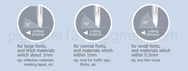

    ok we know we should use different blade angles for different jobs, but who does.
    if you do what is the main difference you find ?.

    I couldn’t tell you the last time i even asked about the angle of a blade. its just bog standard Graphtec vinyl cutting blades we use.
    i remember about 17 years ago when we would cut T-shirt Flock in our old Gerber 4B vinyl cutter, we had to have a different angled blade then, but other than that, its not something i give much thought to. I am sure there will be good reason for the angles though. 🙂

    I think a rule of thumb would be the thicker the material the greater the angle. I’m pretty certain that my old Roland literature recommended a 60º blade for reflective and sandblast material.

    Yep correct Steve – I have two holders set up all the time .. one with a 45 deg for normal vinyl and one with 60 deg for reflective and laminated prints requiring die cutting

    Hi Chris…. I found some info on flea bay some time ago but it seems the 60 deg (as per the info) does not cut small letters as good as the 45.. I just use a 45 deg for anything… even T shirt vinyl.. Still works and weeds well.

    I tried the different blades when I first started, not knowing any difference.
    but I never saw a difference in the cutting quality,
    just use standard blades now for all material, just change the pressure to suit
