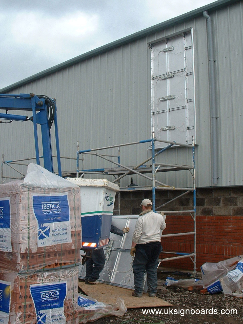

    the sign came in four sections, heavy at that… and the bottom of them must have been about 13 foot off the ground i think.. when we moved them into place the wind and rain was a bit too much.. after an hour or so things calmed down and off we went.
    picture one
    the first picture shows section one in place. ide say this has to be most difficult because it must be “perfectly level” because if its not, and the other sections link onto it, over the 20 foot any running off would increase a fair bit over the lengh of the sign.
    anyway…
    picture two
    all the sections are now in place. all running spot on level and ready for the bulbs to be installed and wire connection’s.

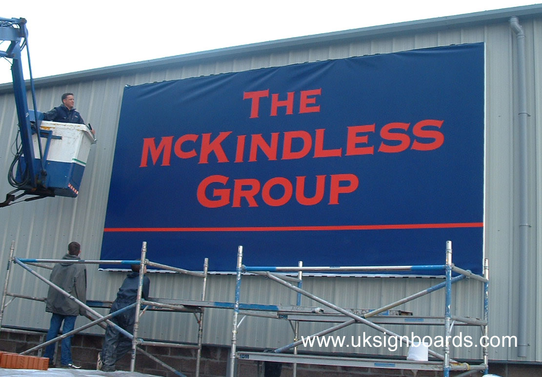

    picture 3
    here you see all the bulbs in place and wiring rigged up, Ive turned the bulbs on to make sure all is OK before applying the skin.
    if you look close you will see black bin liners over the gear trays. i did this because the rain came on heavy and i didn’t know if i was gonna have to abandon ship.

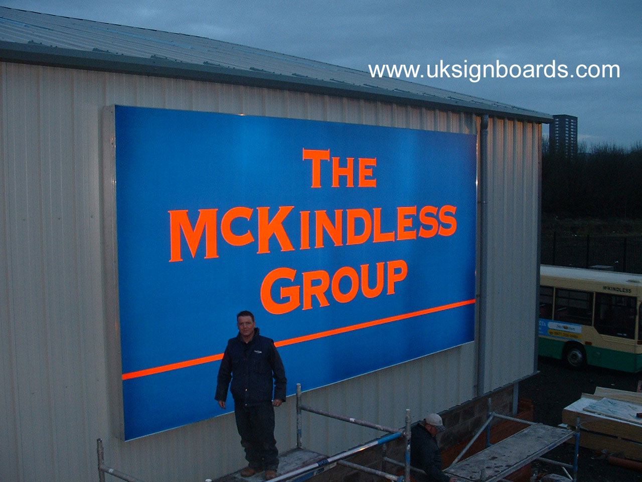

    picture 4
    here i have the skin loose but in place. from here i go around the whole sign cranking the brackets to tighten the skin nice and even over the whole sign making it drum tight.
    picture 5
    after the skin is drum tight i apply some aluminum edges to the sides, top bottom to hide the brackets etc and complete the job, just in time as the rain was coming back on and it was starting to get dark.

    That’s a hard day’s work matey, especially in rotten weather. What kind of fixings did you use to fix such a large, heavy sign to cladding?

    the fixings i used were “wood-tech screws” they are the same ones i use for all cladding work but without the self tapping tip. you have to dril a pilot hole about 4-5mm then in with the wood-tech. the wood tech is a beefy threaded screw that really grips the cladding no sweat at all…
    i also had some 5 inch stell-tech bolts to basically catch the building steel frame work but i didnt feel it needed them at all after using the wood-techs.
    the job start to finish took me and two guys about 5 hours. it could have been faster but because of the cold high winds and constant rain it felt like years…. 😕

    …just being a little picky but the illumination does look a little uneven on the finished pic – Most of the flex face ones I’ve seen always amaze me by how well diffused the lighing is in such a thin face material.
    I guess you cant use led’s for lighting this size of sign just yet 😀 !

    17 March 2005 at 23:13
    i thought that too nigel… but as it got darker the face becomes more even lit for some reason… when we first illuminated it it was very patchy but as sun goes down it starts to look nice…

    What’s weird is that the hotspots seem to run vertically, whereas the tubes are horizontal. Is the print a bit patchy? I know it is difficult to photograph illuminated signs as the camera always seems to exaggerr…exaggger…exajer……show up the tubes more.
