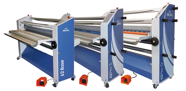

    Our old Seal one had 1650mm rollers, which was a bit tight on 1600 rolls.
    The new one has 1700mm rollers, so a bit easier. I think most of them would be wide enough to do 1600 rolls if they are advertised for that width. Not sure about EasyMount or other brands.

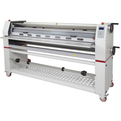

    Easymount EM1600 – 1700mm rollers

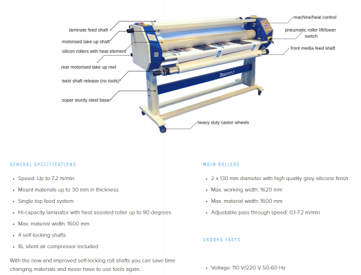

    The Mounters Mate laminator is 1620mm wide.

    June 25, 2021 at 3:33 pm
    I love our mounters mate, for it’s accuracy we’ve ran 30+m through it with no issues.
    The only thing I miss from the easy mount it replaced, is when loading 1600 rolls, there’s not about 10mm each end, and the plastic brackets it fits into are awkward to locate, especially juggling a full roll. Same when using a snitty/bodyguard knife to cut the backing, there’s not much room to get the tool in, and out at the other side.
    However, it’s only occasionally we laminated 1600 wide, and is something I can persevere with.
