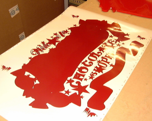

The sign panel (below left) was cleaned with both natural wood turpentine and ‘panel wipe’ (available from car paint suppliers). The workshop was pre-heated to over 75 degrees to aid drying during the wet application process. The main piece of vinyl (below right) was dark brick Red in colour and incorporated shadows, background stars and the shapes of all the key elements within the sign.
Because this main piece of vinyl was wider than my plotter, a good friend called Dominic at Kingdom Signs cut it on his 1220mm wide Graphtec and that’s why I ended up having to use two pieces of my narrower application tape to both cover and apply it (below left). We used a lot of water during the application of this piece (you can see it shooting out from under the tape) to ensure we had ample time to both position and ‘work’ it. The tape was eased off within minutes of application to allow us to troubleshoot this piece (below right), particularly where the join occurred in the application tape which is where bubbles typically appear.

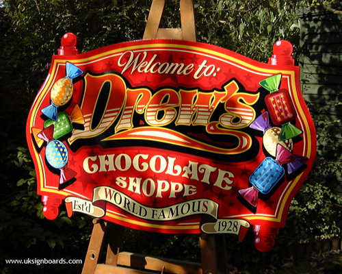

Now we’re on the home straight! Onto decorating the Chocolates. To begin with, we apply the various base colours that form the body and ends of the wrapper for each sweet (below left). Then, slowly, and painstakingly, we add the various colours to create the highlights and lowlights within each. First one sweet…
…then two……….then three.
Same for the other side of the sign – same process, only different shapes and different colours too!
It’s finished! Placed outside in dappled sunlight on a simple artist’s easel – it looks splendid.
The sign was left for four or five days to ‘cure’ and dispel most of the moisture from between the layers. Surprisingly enough, the entire application process took less than a morning with cutting and weeding having taken all of the afternoon before. Not once did we use a tape measure during the fitting or, come to think of it, throughout the entire process – sign-making without ‘rules’ indeed!
