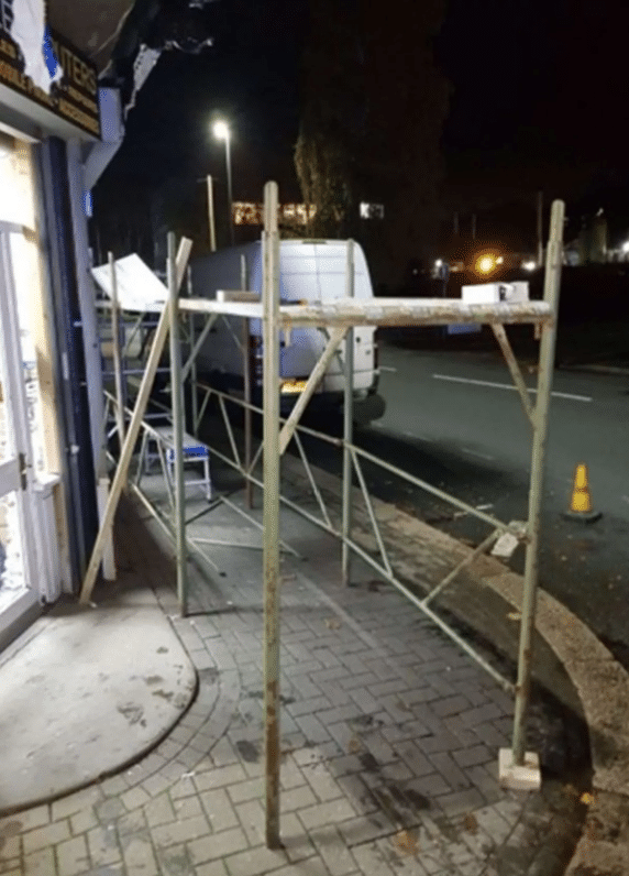

Mr Iftikhar Ahmed Mughal was working for WH Metals Limited on 22 November 2022, installing a metal sign on the front of a retail unit in Darwen, Lancashire. While positioned on a mobile scaffold tower just six feet high, he fell from the unprotected platform, sustaining critical head injuries. He died in the hospital four days later.
An investigation by the Health and Safety Executive (HSE) found that the tower scaffold lacked essential edge protection—a basic and long-established requirement in working-at-height procedures. The company director was on site during the incident but failed to implement adequate fall prevention measures.
HSE guidance makes clear that guardrails must be used on all tower scaffold platforms to prevent falls from height. Despite the relatively low height, the lack of edge protection had fatal consequences.

“Work at height remains one of the leading causes of workplace fatalities. A fall from just six feet was enough to cause death. This incident could have been prevented with simple and well-known control measures such as guardrails.”
