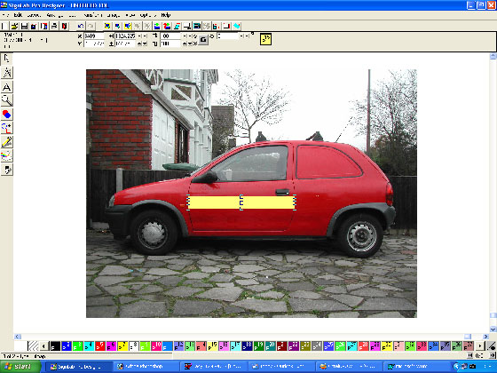

Open your photo and draw a panel over an area that you know the size of, in this case, the door width.
(Step 2)

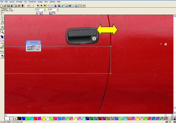

Double-click and come in close to adjust the panel to be exactly right.
