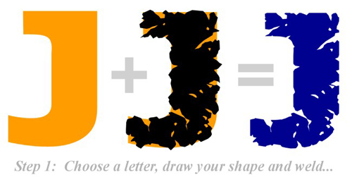

We’ve chosen the letter ‘J’ in a font called ‘Aardvark’ and coloured it Orange. Using a ‘freehand’ draw function we make a ragged shape that roughly follows the letter’s outline. Weld these two items together using an AND weld function (one that leaves those parts common to both shapes).
TIP: Keep a copy of the original letter ‘J’ and save it to one side for later.

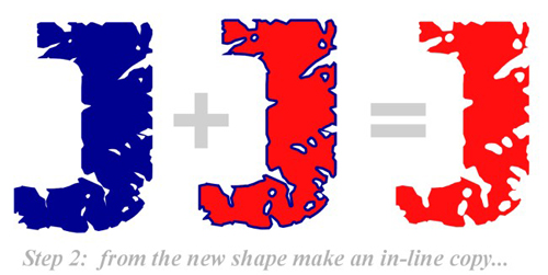

Take this new shape and make an ‘in-line’ copy ( a slightly smaller copy) in a different colour.
TIP: Once again, keep a copy of the original piece (shown in blue) to one side.

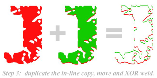

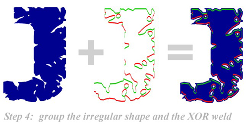

Make a duplicate of this in-line copy. Place one directly over the other and then move one a small distance in any direction. Weld the two using an XOR weld function (one that leaves those areas not common to both) and then colour the remaining pieces to form two coloured groups. One of these will become the highlights and one the lowlights.

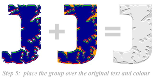

Take the shape created in step 1 (the blue piece) and group it with the newly formed highlights and lowlights – be sure to carefully align all three.
Take the original Orange letter ‘J’ and place it behind this newly formed group taking care to align all of them carefully. It is at this point that you can apply your chosen colours to the various elements of the design. Often the effect is created using three shades of the same colour together with white highlights.

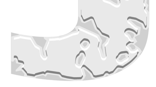

Here’s a close-up of the effect and the colour uses.

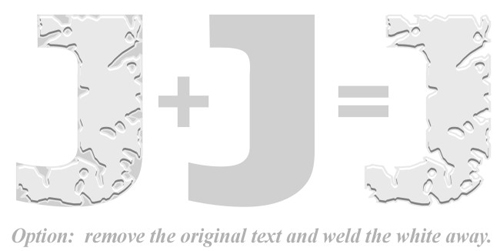

You can simplify the final stage of this effect (and the number of colours used) by NOT using the original letter shape behind. In this example, using white behind, only two other colours are used – mid-grey (with the white highlights welded through it) and a dark grey shadow.

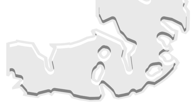

here is that same lesser colour option in a close-up:
