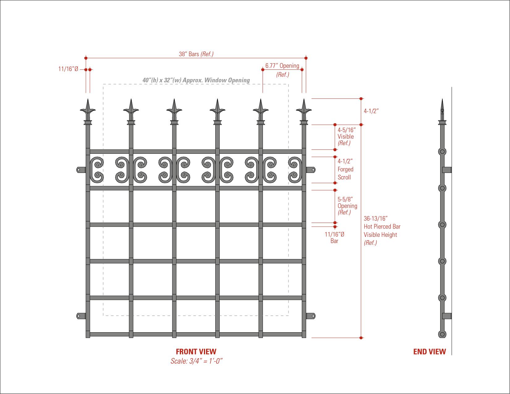

    Ok, so here’s my first draft for the design. I will still need to meet with the blacksmith to correct any problems with construction. The mounting tabs are probably done wrong too. When done I’ll post some pictures. The wife gave me he!! about the gold leafing too! To bad that $5 – $10 of gold leafing would make me look too rich.
    Thanks again for all the previous replies.

    Looks good, but do you not think its a bit too much steel. The openings seem quite small. They could be opened up to about 9" vertically with fewer horizontals, you just need enough to stop a small child squeezing through.
    Just a thought! 🙂

    Of course I’m open to any suggestion anyone has as I’ve never dealt with any type of iron work before. One of the dimensions is already set because the bars are hot pierced but come already pre-formed. It was one of the many questions I need to sort out with the blacksmith. I don’t know if he can take a regular bar and pierce it himself. Of course the other dimension is adjustable depending on the overall width and how many bars will be put in. It would certainly make it cheaper by taking one bar out and distributing the widths. Less material and welding time. I only went that way because he (the blacksmith) suggested 6" x 6". But now that you mention I’m going to take my drawing and do a few more sketches to see how it looks with it more opened up. I’ll have to figure up the weight to get an idea. Not really sure what my brick wall can handle. I suppose it depends on the mounting as well.

    Make sure your mounting brackets have a good purchase, you don’t want to drill to near the edge of a brick.

    I totally agree. I thought about that but didn’t want to do to much planning for that because I’m not sure exactly how he wants to do the mounting. I’ll measure and draw the bricks up after I talk to him to make sure that the holes will be far enough away from the edge of the bricks so no breakage occurs. It’s possible that he might even use a full length of angle on each side.

    I don’t know how it works where you are Simon, but for a blacksmith to form from scratch would cost a lot here, most of our wrought iron comes from India, is preformed and is very cheap. finials, twists and hot pierced iron is quite labour intensive. so most suppliers buy in the components, and and just spot weld together.
    not a lot of help, though. just a comment

    He let me borrow the catalog with all the spec’s in it. So that’s what I used to draw up my design. The bars, finials, Scrolls and Tabs are all premade parts that he would cut down to size (where needed) and then weld together. I didn’t know if it was possible (or feasible really) to take a pre-made bar though and hot pierce it. If it’s more expensive to do that then it’s really not worth it in my case anyway.

    as Peter stated components are purchased & welded together, i attached a link to give you some new ideas
    http://www.fhbrundle.com/iron.htm

    Thanks Kevin. I’ll have a look. I might be able to find some better scrolls that can fit in the openings. I was having a hard time finding ones small enough to fit in the other catalog. The finial spear points that I used was specified to be used on 3/4" square, but the bars are 11/16" round. So will probably need to find a more appropriate fit.
