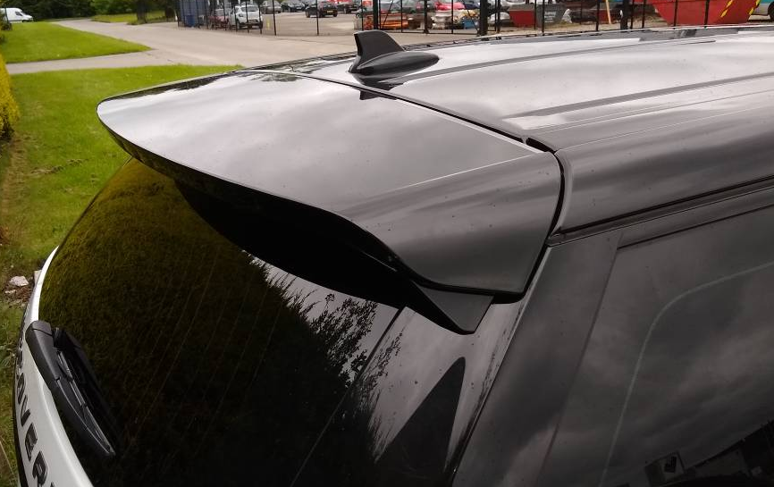

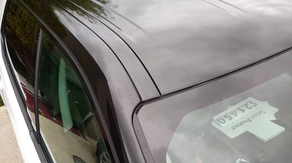

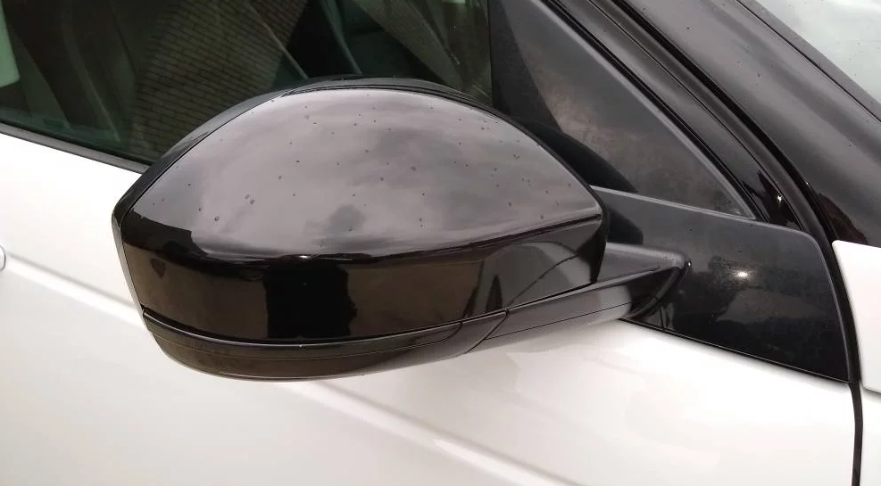

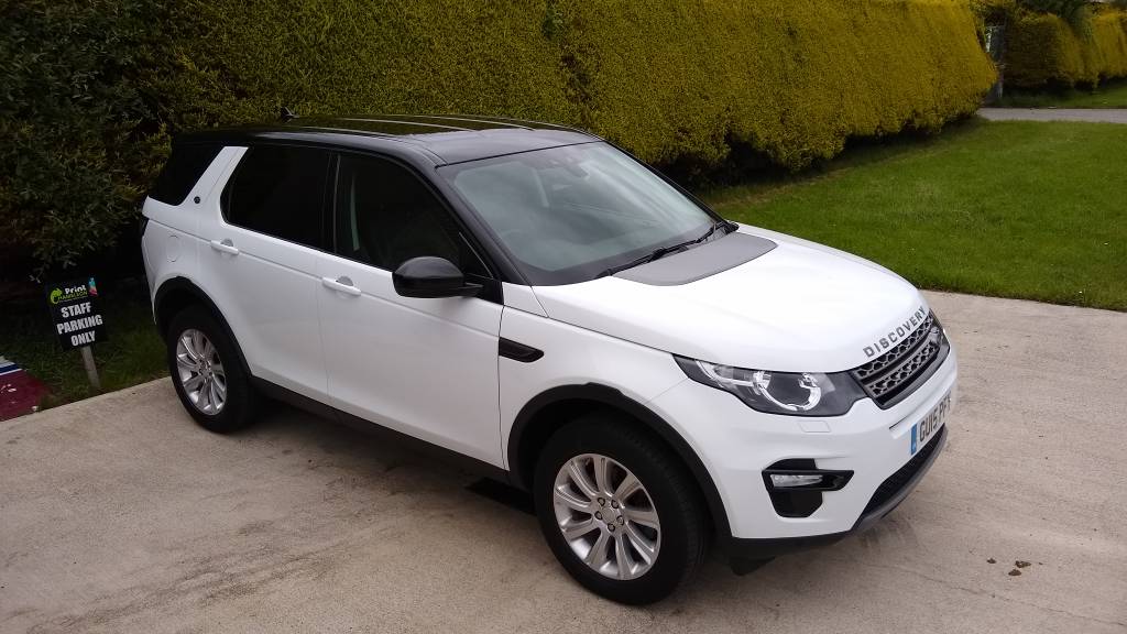

    I’d be tempted to say 4-5 hours. Like Rob said a lot depends on how much finishing is needed. Also bear in mind you might need to do a pile of cleaning 1st, especially behind the rubbers and also under the roof strips if there is any. I find it very useful when wrapping the side parts to draw a line using a dry wipe marker on the body with the doors closed to show how far the material has to come down on the sides. When you open the doors you can then apply cutting tape 10mm in from this line to make sure the door rubbers don’t catch on the material. Not sure if that makes sense or not though lol.
    Here’s something similar I done a few weeks ago.
