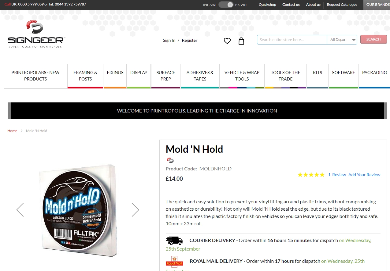

    This is what you need for the job, It’s black and will look like the original seal.
    signgeer.com
  • Jamie Palmer
    23 September 2019 at 18:10
    Looks perfect, appreciate your help!

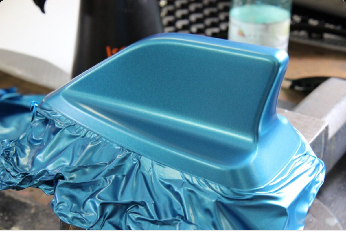

    It can be done in one piece as shown here. We didn’t do it though :smiles:
    21 October 2019 at 05:57
    Doing them in one piece is not easy, but is doable. The more important part is it staying intact!
    Not lifting out the deepest part of the stretch, not curling back around the base etc
    This is because, if overstretched at the deepest angles, the adhesive on the rear is almost gone, meaning there is nothing to hold the super tensioned vinyl in the place you have put it.
    now if this fails a few days later, or even a month or so down the line.
    you will have to renew it. to do this, in some cases, it means lifting the newly stuck with double-sided tape Finn from the newly wrapped roof. will it come away without damaging the roof?
    many things like this are doable, but your stretching method and being able to relieve stress and tension where it is required is the skilful part. not just a seamless 100% coverage.
  • Kevin Mahoney
    21 October 2019 at 08:51
    Agreed Rob. That masterpiece shark fin that took some serious skill & time, was met with a shrug of the shoulders from the client & some sleepless nights for the installer worrying about whether it’s staying put. I’m seriously impressed by that little piece of work but I’d piece that together & sleep much better.
