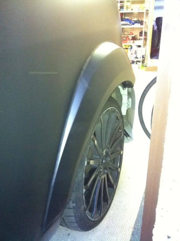

    I’m currently wrapping a Ford Focus ST that has has the RS kit fitted to it and having a couple of issues with the rear arches. All of the panels my customers has bought are genuine (bonnet, wings etc) but the arches are moulds that are tiger sealed onto the existing rear quarters. I’ve wrapped one arch / quarter but as the recess is REALLY deep(!) its coming away slightly in the recess all the way round the edge. I imagine its because of the stretch needed but I cannot think of any other way of doing it. The customer has seen it and is happy but i’m not 100% happy with it.
    I’ve attached a pic of the below of the arch in question. How would you tackle this? Would you do it in 2 seperate pieces somehow? Vinyl im using is the 3M 1080 series matt black.

    i would do it in two sections, if its releasing already it is under too much stress already and will only get worse.
    do have a pic of the actual reccess setup?

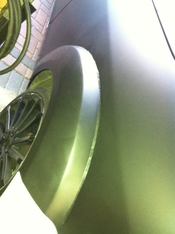

    Here is the pic of the arch in question, only my 8th car i’ve fully wrapped and first barrier thats hit me!!
    How shall I do it?!!

  • Jason Price
    29 March 2012 at 21:17
    Yup, defo do it in two sections, trim the arch away and make sure you have a little overlap left from side panel to lift and rehearing back down, leave this loose for now, refit the arch then heat the overlap down then a nice clean join line using tessa tape as a guide. In my experience there won’t be a material on the market that stay put in that recess far too deep. Hope this helps! Feel free to give me a call if you need to, Jas

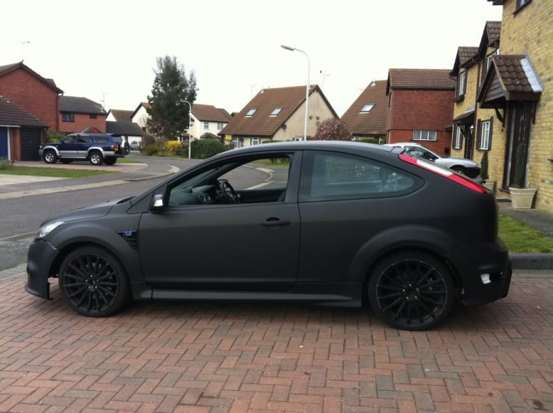

    Jason – great advice, did exactly what you said and it worked perfectly! I even managed to keep the rear quarter vinyl in tact but gently lifting, applying the arch vinyl the laying over the top on a neat edge. Customer was over the moon with it! Thanks again mate, actually feels like I’ve learnt something!! Quick pic below before he collected it, bumpers etc are all still loose (actually a very nice customer who made my life very easy taking bits off for me!!). Just needs to fit the wheel spacers and coilovers!!
    Craig – used the 1080 series 3M vinyl! First time i’ve used it (always used hte 85 series) and its great to use, very easy and forgiving!
    Mark – it is a very deep recess and the fact it goes around a fairly steep corner at the same time makes it nigh on impossible to get it to stick. Car is a 2007 Focus ST with a focus RS bodykit fitted (genuine panels). The arch extensions have been tiger sealed on so very doubt they are going to move! (only non-gen part as genuines are a complete rear quarter with the wider arch.
