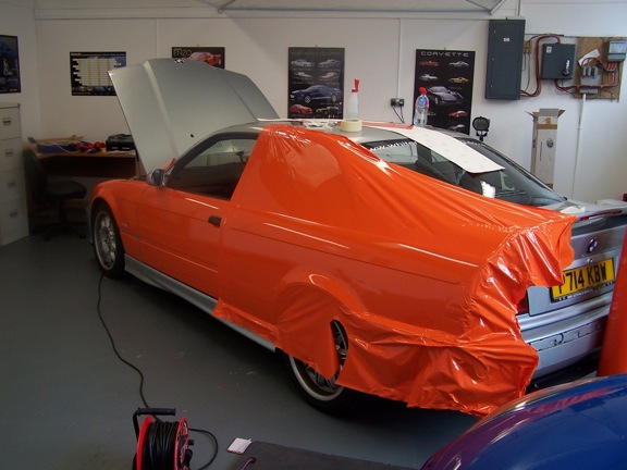

    I wrapped this car with Avery 900 and it was OK for me, it wasn’t even in a heated room, it was in a garage but no heating. I did not get bubbles but did find it difficult just because it was hard to handle the thin material. It’s not the easiest material to use but is possible and it was my first wrap too 😕

    As this was only going to be on for La Mans he was not very concerned about joins etc, I joined at the bottom of the window arched and fitted front half and back half in 1 piece as seen here.

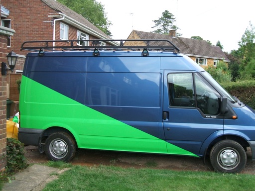

    Simon can you post a side view of the van?

    I’m afraid I don’t have any pictures to show you’ll. Me and the customer end up getting pissed of at each other and things got kind of loud. So I just did what I had to do and got out of there as quickly as I could.

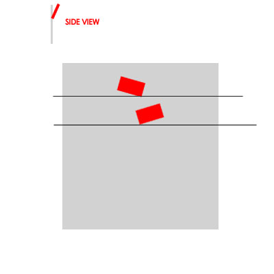

    Bubbles mean your not getting all the air out when applying the vinyl. Let me post my squeegee technique in a diagram.

    Its called the 30/30 technique.
    Basically you hold the squeegee 30 degrees against the line your applying and 30 degrees off the body of the vehicle.
    Your application line can vary and can follow the curves on the car. This illustration is simulating a flat panel application.
    You will be guiding the vinyl outwards so you shouldn’t have creases nor bubbles if you use small overlapping strokes. You also give the air a chance to escape. Also work from the middle outwards so from the middle to the edge of the sheet. The the other way from the middle outwards again.

    We also use that 30/30 technique, but I believe that we make far to big leaps with the squeegee between lines.
