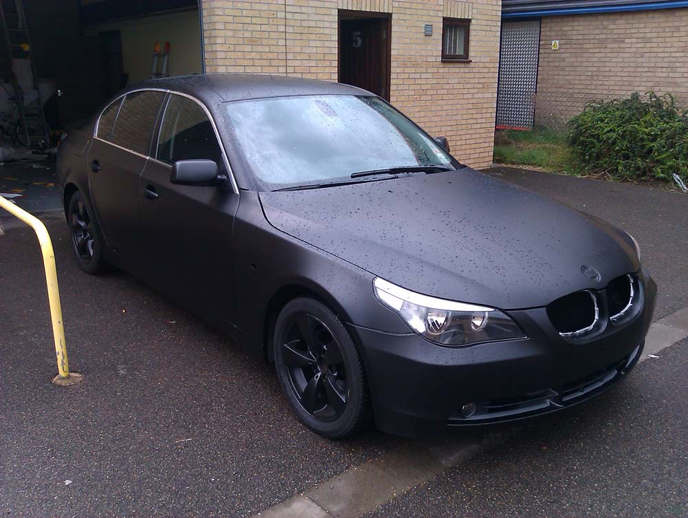

    Hi all,
    God I haven’t been on here for months.
    Ok, I got a BMW 5 series to wrap in matt black vinyl. I’m a one man band, with no one to help fit, what material do you recommend for fitting on my own.
    I’ve used Hex-press digital before and was a dream to work with. But at the moment they don’t have any stock on matt black wide enough to the bonnet in one. I don’t want to do any joins if I can help it.
    Hope someone can suggest a good material to use with bubble free tech.
    From Mark

    Hi all, I used the 3M matt black in the end, yea it was a lot cheaper than Hexis
