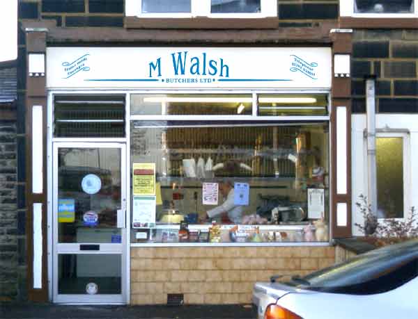

    hold on to your hats, but this could be my first job. The client liked the direction
    its going, so far; but I’d welcome any thoughts you’d like to add before I come up
    with the final layout.
    I did have a version with solid scrolls in the same colour blue, but they were too
    heavy and sought too much attention. I also had an orange drop shadow which I may
    or may not reintroduce.
    I have some close ups of the hoarding(?) and would like to seek suggestions
    as to mounting
    or applying the final job, would that be ok to do in ths thread?
    Anyway thanks for looking and for any advice you may have to offer.
    ps text in scrolls reads "home made sausages" and "telephone 01982 etc"

    Heres a later version (my prefered) but I get the feeling the client may want to stick with the arched text of the original.

    Hi Peter,
    I think the second design is cracking.
    The sign would be nice on 5mm foam PVC gloss, to finnish it off a small ali frame.
  • jon vital
    17 November 2003 at 17:03
    Second design is much better. The lettering on the first one looks lost.
    I would add a dot between M and Walsh and maybe try to get the bit’s at the ends bigger.

    Hi Peter.
    My computer has PMS today & it won’t let me see your second version.
    My opinion on the first was…
    Liked the scrolls….maybe move them in just a bit tighter.
    The lettering in the arch needs to be not as tall (remember negative space) and if you softened the arch & stretched the name out a little bit more it would look bolder.
    I like your style kiddo!
    Love- JILL 😎

    just playing while my edge is printing
  • John Singh
    17 November 2003 at 19:47
    Adrian has said it really with his design
    It is appealing to have a little flourish now and then but caution needs to be exercised if this is going to interfere with legibilty
    For example in your first example you had to tell us what the sign said and yet the picture looks as if it was taken from no further than the middle of the road (risky taking a picture from there! 😆 )
    A sign, at the least, should be able to be read, without squinting, from the other side of the road.
    But certainly full marks for originality and breaking away from what some might consider convention

    Thanks for the feedback everyone.
    As John says, Adrians design really says it all.
    Couple that with the chat I had last night with Mike and I can see where the ‘mechanics’ (to quote mike)
    of the sign just aren’t working. I can’t tell you how good it is to have all this experiance around
    offering honest critique and guidance.
    I know theres a book out there most of you swear by, re layout and hopefully
    my local library service is beavering away as you read to wing a copy of it to me.
    Thanks again to everyone, who contributed.

    Ok, I’ve used some of the advice/suggestion given and come up with the following…

    Peter,
    I think it looks great, and would be very proud if it was my first sign
  • Tim Painter
    19 November 2003 at 13:24
    Looks good to me Peter. 😛
    Simple & well balanced layout.
    Not to busy with a modern / traditional style I guess if that makes sence.
    Well done onwards & upwards all the best.
    Tim.
  • magpie
    I had to delete the 2nd draft to post this version.
    I think its better now for all your suggestions, it speaks clearly rather than whispering or shouting 😀
    My next task is to work out how to make and install it, so suggestions welcome.
    Oh yeah here are the dimensions of the face board already there 146″ by 20.5″
    Personally I have the following concerns:
    i) That keyline is long and would use at least 4m of vinyl, is it an expensive luxury
    ii) Other than producing a wooden sign and painting it cream are there any other options
    or would I have to go for a white (fomex, perspex)?
    iii) Artwork is illustrator, can guys who cut vinyl (I’ll be farming out) use pure AI files
    with text converted to curves.
    I’m sure theres more but thats it for now, thanks.

    Solved point ii) – I’ll be going for Panatrim with a cream panel (front loading version)
    All the same if the actual shop front panel measures 146″ by 20.5″ what measurement
    should I give for the frame (ie 145″ by 19.5″, to allow a half inch each side)?

    Preview the file in wireframe mode and you’ll be able to see if it is cuttable or not. You may have to do something with the contour around the main text.

    In my Opinion:
    quote :
    I think missing out on this would change the whole appeal of the sign.
    You’l have to cut the boarder so cut the corners seperate and then the long and short bits, possition the corners and then put the long and short bits down. If it’s cut on a 24″ plotter it should all fit in one section 12’6″ longish.
    quote :
    ii) Other than producing a wooden sign and painting it cream are there any other options or would I have to go for a white (fomex, perspex)?
    You have this sorted now, but you’d definately need a front loading panatrim sign, incidently where are you getting the cream panel from?
    quote :
    iii) Artwork is illustrator, can guys who cut vinyl (I’ll be farming out) use pure AI files with text converted to curves.
    From experiance most sign packages will take an Illustrator EPS file but save it down to version 6 and it’s a good idea to convert the text to curves. The only slight problem you might have, as John says, is with the outlines, if they are just made from single lines with a stroke thickness this will cut as only one line. If you view it in wire frame and only see one line for the outline then you need to make it two seperate components so you see two lines, as it’s these lines in wire frame that will determine what the cutter cuts!
    I hope this helps
  • magpie
    20 November 2003 at 09:34
    Jon/Lorraine yep it looks like the outline will be a problem, is there a niffty way to get
    around it other then using the pen tool to create it?
    (I think I may have a solutions but its a little involved to explain in a brief message and
    may be far more complicated than need be. Especially if its already been sussed by someone
    already).
    Lorraine when I spoke to ‘Universal Architectural Aluminium Systems’ about the frame
    and panel, I asked them if it were possible to have a cream panel. Does this sound unusual
    to you?
    If so I’d best double check before speaking to the client.

    Hi peter,
    I have done a few signs with cream panels..
    “Classic Night Tandoori”, there is a photo on this site some where, have a look, that uses panatrim frame and cream panels
    Simon
