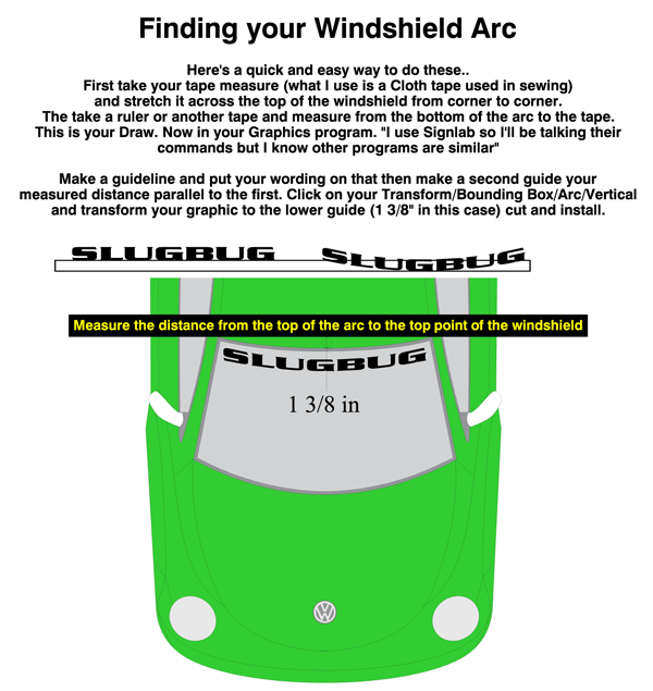

    Just a quick question when fitting a graphic to a windscreen when its lettering. If you cut the letters straight it obviously bends with the curve of the windscreen. Is it just a case of curving the graphic when cut in the opposite direction to the way it bends on the screen?.

    Lay a straight edge across the screen and note the distance to the rubber at the ends bend your lettering (Mr smiling ) by that amount. Same trick for a bonnet.

    Here ya go..

    Nice 1 Chris, thanks for sharing
