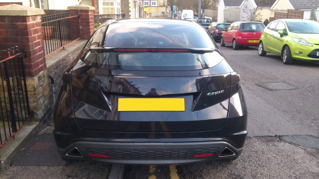

    7 March 2014 at 22:47
    wonder what people on here will have to say about this one I did a while back, oh and it passed MOT by a reputable MOT station that does everything by the book
  • John O'Sullivan
    8 March 2014 at 00:23
    quote josh morris:
    thought it would need a reg plate to pass the mot πŸ˜€ :D,as for reputable mot stations do they not all have to work to the same rules/standard :o….. :lol1: :lol1:
  • David Rogers
    8 March 2014 at 00:47
    quote josh morris:
    …pretty much gave up caring 2 weeks ago…
  • josh morris
    8 March 2014 at 01:09
    ive blanked the number plate out :lol1: and yes they do, but as David said that Some testers will pass anything I thought best to clarify
