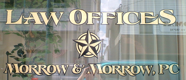

  • Lorraine Clinch
    6 September 2006 at 11:55
    Hey Jill, the law Offices window looks great! Butoutside? Do you not have a problem with young oiks over there? Any window signed on the outside over here will be picked off on no time.

    Ye Jill nice work, but dont you have bored teenagers over there?
    I myself would find it hard to resist picking a sign off never nind a half canned youfff!

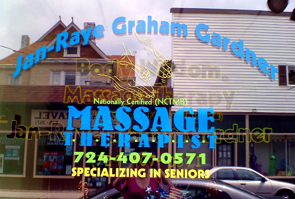

    6 September 2006 at 12:41
    Jimmy…black will have absolutely NO contrast if used on a window.
    (see the home-made lettering on the inside of the window job I posted?…can you read it?)
    You would be further ahead just using white.
    And the kids around here are too busy doing heroin and playing with guns to be bothered with peeling window lettering.
    BTW I did have to re-do that Morrow window due to the failure of the Avery A8 black vynull.
    love….Jill
