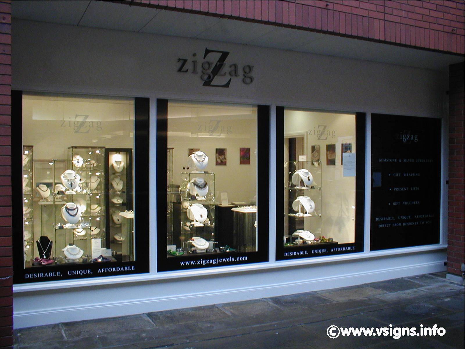

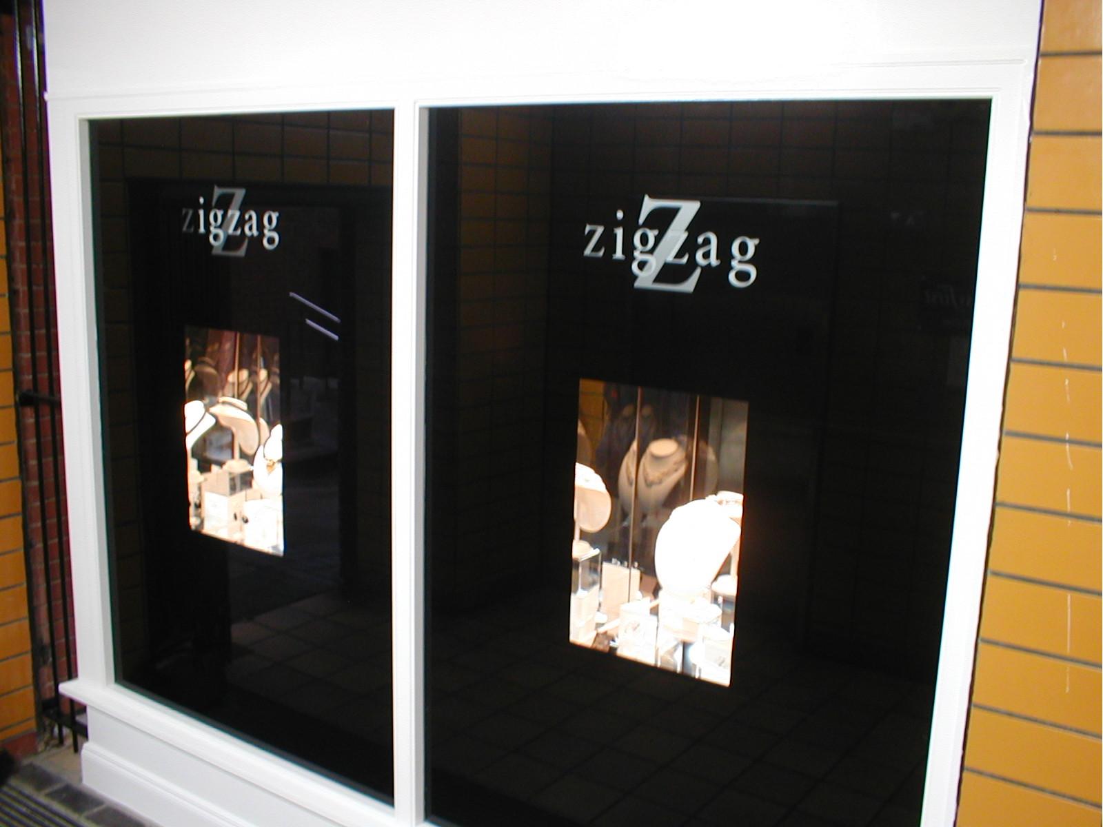

    Hi all I – here’s a recent project a little unusual in that the client required three blacked out windows two of which had to have mirror display boxes in the centre.
    I informed the client about possible problems with the black vinyl but they were happy to risk it, fortunately the windows are subject to little or no direct sunlight. This link posted recently was great for helping determine the risk http://www.iwfa.com/iwfa/member_service … l#Breakage
    Sorrry I’m no photographer but you get the idea

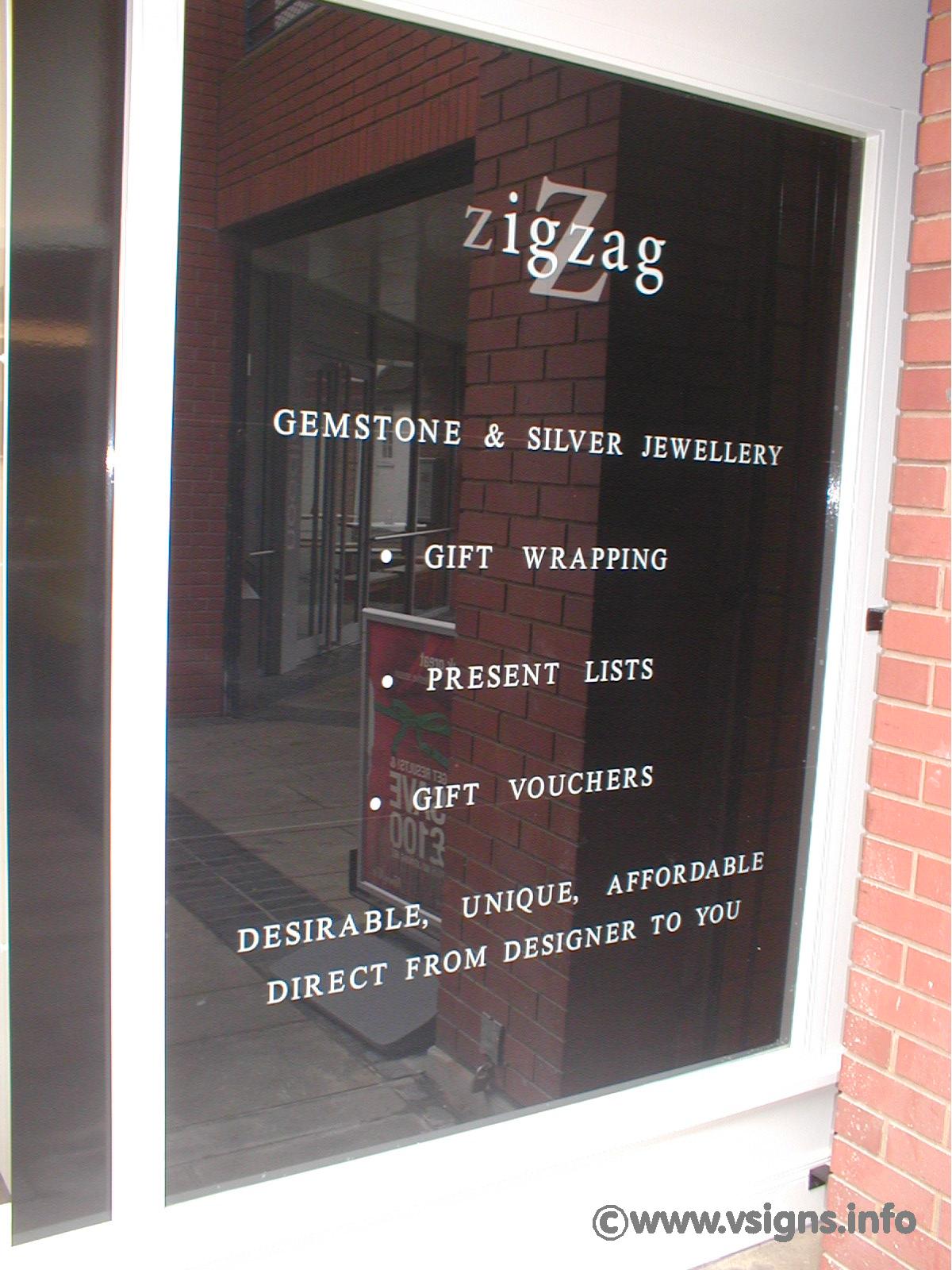

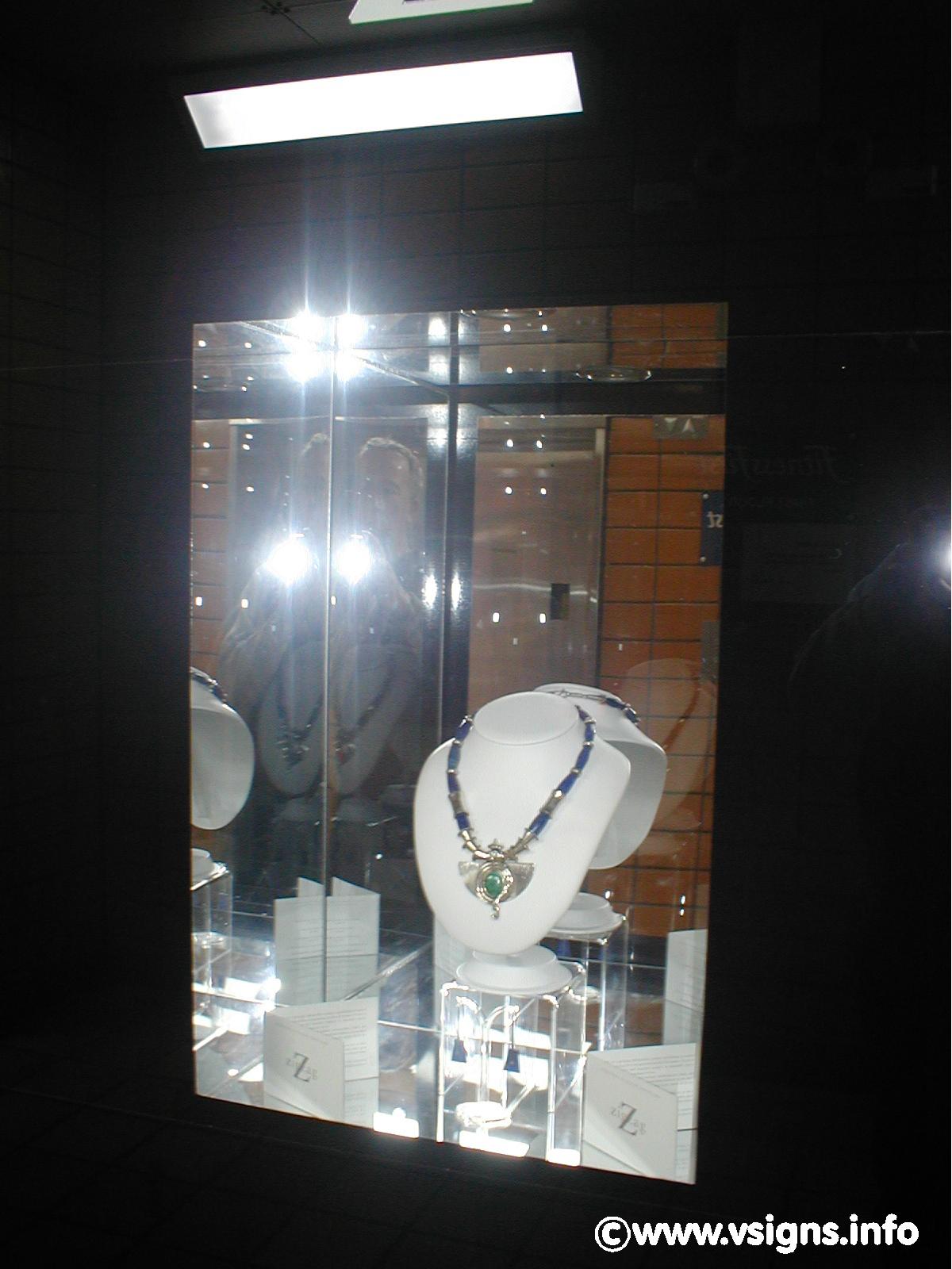

    Ben pretty simple really, in this case I put the graphics on first cut in reverse to the inside of the glass and then covered with the black did this in a couple of pieces horizontally, as I was on my own I found it easier that way, applied wet just water and trimmed tight to the frame.
    Cut the aperture afterwards using a vinyl template
    Here’s another pic
