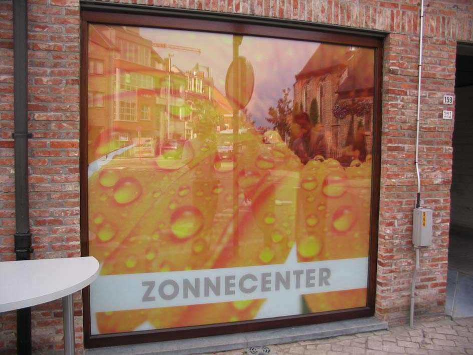

    It’s been a while since i’ve posted some of our work and before y’all start thinking that we don’t know how to make a sign anymore i thought i’d post this nice looking job.
    it’s a tanning salon that has gone through a complete makeover and we were called for the windows.
    bassicily what we’ve done is print in mirror on transparant vinyl,
    after applying it on the window we’ve backed it with white vinyl,
    because it’s on the inside it has a really nice gloss to the image.

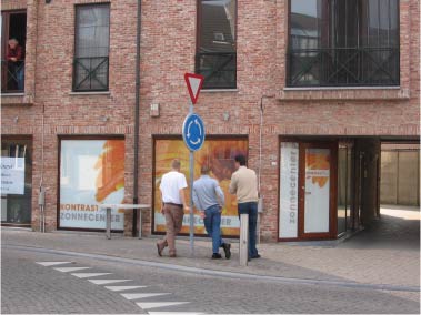

    sorry for us blocking the photo, me, the client and the designer didn’t know that there was someone taking a pic of the work. 🙂
