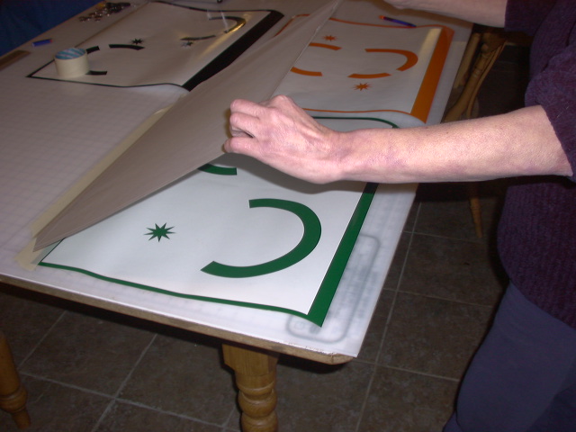

    I Do a similar thing to Shane but I just use my office window.
    There is usually enough light comming through the window to line up two or three layers.
    Each layer of app tape has a longer hinge than the one before so when it comes to fitting you just hinge the top layers up out of the way apply layer one, remove the app tape, apply layer two etc
    I don’t know if this even makes sense to me now
    Paul R(Mackerelbus Design)

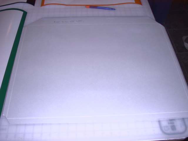

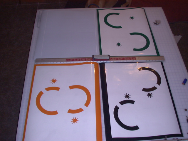

    28 February 2005 at 19:05
    picture of how I do it, should be self explanatory, but can only post two at a time
    Fist pic is just the white lood coat within the weed border.
    Second pic is the 3 other layers weeded withe the same border

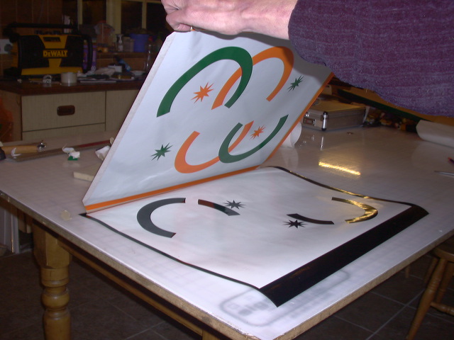

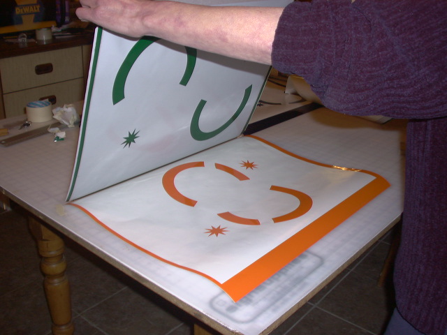

    28 February 2005 at 19:08
    next 2

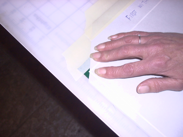

    The white has app tape applied and the corners nipped of to align with the nect layer, taped with a hinge, and then the backing is removed.
    Fist 2 layers are then combined. Process then repeated for nect layer
    28 February 2005 at 19:10
    next 2

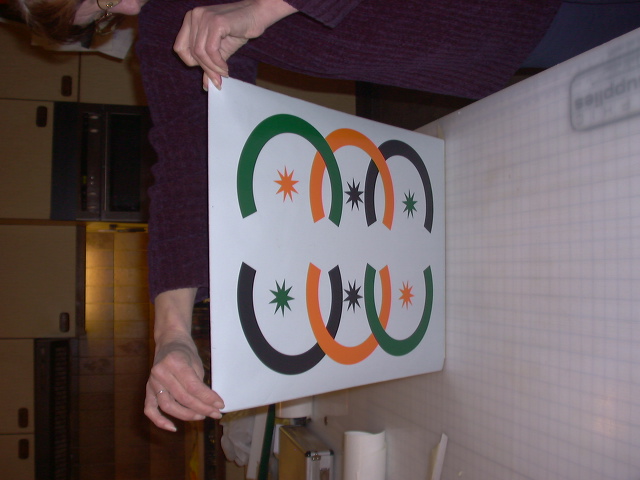

    28 February 2005 at 19:12
    ready for application adhesive side down, backing paper removed
    28 February 2005 at 19:22
    No reg marks or light box, just a border round the whole lot.
    Small bits can be put on as needed directly onto the backing paper in the correct position before starting the process. the last/first layer, in this case a flood coat could be put on the window after if to large to do in the shop.
    Hope this helps

    Thats exactly how I do single layered and multilayered vinyls when I want to lay them up for site. The problem I encounter is I use alot of individual small pieces, then they’re backed with black, then usually white and its all done in reverse for application to the insides of a window. The initial layers are laid side by side, similar to your pictures, but when it comes to the overlaying colours that outline the first layer once in the window, I can’t see what I’m doing and even reg marks don’t guarentee I line up perfectly. I like the windows I do to look good closeup as well as from a distance, so registration is something I spend alot of time on, possibly why it takes me so long as well. 😕
    Do you use a low tack tape to do that Peter or standard application tape? I use the standard Orafol tape from Europoint, a paper tape with a medium tack, maybe thats where the problem is coming from. I can’t stand using the clear plasticy tape, its aweful to work with for me and the felt just slides round on it when I’m applying… horrible 🙁
    Main difference between our techniques is I use reg marks alot, usually huge ones as the old eyesight is letting me down alot.
    Thank you for taking the time to post those up though Peter, you’ve done some work there to put that together!

    quote Peter Normington:
    Pete I’ve been looking and scratching my head for ages trying to get around this picture?
    What’s puzzling me is?
    Is the App Tape coming down on the next Layer?
    If so that begins to make sense?
    If not can you explain a little more, as your making it look so easy.
    I have just done a 4 Layer but i stuck the App Tape down on the table,
    sticky side up, and brought the vinyl layers down to it.
    So i was looking at the backing when rolling out (Bubbles).
    It worked, but a little out on one layer 🙁
    I’m trying to find a method I’m going to be more comfortable with.
    Hopefully seeing that Pete has no problems,
    it may rub off on me to?
    Thanks in advance.
    Mark

    I’ll try to explain a little better, sorry if the pictures were not very clear.
    This was done to demo for vinyl to be applied to a window, on the inside. the first pic you posted is in effect the last layer, from the glass outward.It is just an oblong of white, to which all the rest will be layered.
    only one piece of app tape is used. Dont know if this explanation will make sense but…Treat the backing paper as the substrata (whatever the vinyl will be applied to) then its much the same as robs demo, you just keep adding layers. And then the final layer is put on the van/plastic/whatever. Hope this makes sense.

    i can se the principle/theory of what you’re doing, it looks pretty simple when the graphics are fairly well spaced like they are,
    what i think i’m trying to say is….
    when i layer, depending on neccesity, i’ll often use a large ‘contour’ behind each upper layer, so as to avoid unsightly ridges on the upper layers, i can see that my method will not always be applicable, and unless i see how dewi built up the villa, i’m still no wiser as to how to build up a larger image in reverse, either o the glass or on the bench, i would feel the need to use outlines rather than layers to achieve the same thing that dewi has here !
    damn, confusing myself now !
    6 August 2005 at 20:50
    Layers are usually better than as you say”outlines” When vinyl is but joined it can and does shrink, leaving gaps, and if you over lap or bleed onto the adjoining colour you can get an unsightly line, and colour change, especialy between light and dark shades, if this makes sense
    peter
    6 August 2005 at 20:58
    The top line is my prefered method if you see what I meen
    there is less chance of problems if the registration is slightly out.
    The bottom line can risk a gap between the layers.
    6 August 2005 at 21:00
    yes Pete, it makes perfect sense ! that was why i was saying i like to make a full layer for each errr…layer !
    6 August 2005 at 21:28
    Go on Drag on, you know you should, and trust me, its well worth the beer money, hand over about .00001% of your turnover to the boards.
    You will get the benefits.

    Cheers Pete,
    Its all making sense now.
    If i just treat the Hinge Layer in the picture as the app tape
    i should get there 🙂
    Thanks for sharing…
    I can share Bubbles and Creases if anyone intrested lol…
    Thanks again.
    But its now a useful demo if i need to stick on the inside of a window too 🙂
