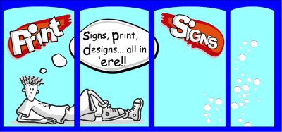

    After being inspired by Terry Bull’s excellent ‘Window Splash’ I’ve decided to do one on my shop window, get my shop noticed from day one. And why not, I’ve stuck vinyl to everything else in the shop, I may as well start on the glass 😉
    Anyone who’s seen my special offer A board will know I kind of like the Fido character that boy racer’s have on their cars. So I thought, cool, I’ll stick Fido in my window. That was about 2 hours ago! Since then I’ve been playing with shapes, sizes, different images of Fido until I settled on whats below. It isn’t finished yet, but I thought I’d post it and open it up for a bit of creative bashing about.
    I’m not precious about this design, although I like the large Fido chappie, but I added in the bubbles on one side as thats where the window angles towards the door and I thought it’d be smart to overlay my opening times in standard black arial text.
    Cheers, Dewi

    I like it. Just a couple of things: The word print looked like ‘Frint’ when I first looked. I’d try a couple of sample colours on the glass before you decide on final colours; black can be virtually invisible on glass.

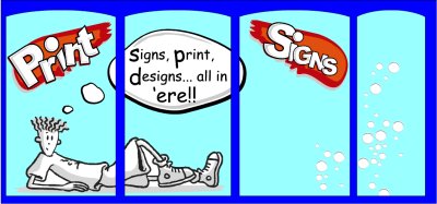

    I’ve altered the ‘Print’ bit, I hadn’t noticed that 😳 Do you think maybe a thin white outline around the black will make it stand out more?
    One of the hardest things I’ve found with this is scale. The shop window seems to be a huge space, but when you start spacing things out in it, it seems to get smaller 😮
    Cheers, Dewi

    I don’t really know to what you’re referring. The fido character with a white fill should be fine. I always check colour combinations together by way of a small sample when working on glass as it can do strange things. Colours tend to lighten and dark colours can disappear completely. I assume you will be applying to the inside of the window, which calls for some careful positioning when overlaying, and meticulous squeegeeing around any overlaid parts to remove any possible air outlines.

    As bigG says, I’d definately steer clear of using any plain black (or other dark colour) text/graphics without a lighter outline. Are you going to put all the shaded parts on the fido figure ? I think this would look great but could be a bit tricky to fit, epsecially on glass ? Same for the colour splashes at the top, quite a few layers of vinyl there by the looks…. but don’t let me take any of the wind out of your sails, if you feel confident then go for it, I’m sure you will end up with a great looking display 😉
    One thing I try and do when designing window graphics is to photograph the shop (or whatever) and overlay the graphics on the photo so you get a better idea of how the “actual” colours will look when applied in relation to the interior colour and lighting etc.
    You could always simplify the figure into just a plain white outline and lose the shading to make it easier ? Maybe I’m being a bit defeatist, obviously you layout will look better, so it would perhaps be worth the effort/practice !

    Did a little research on window splashes and 100% right, everything done in black on a window is outline in white to make it stand out. The Americans seem to be mad on window splashes, they’re everywhere. Even when the shop owner goes to the toilet, he gets an artist in to whip up a quick bit of window art to explain he’ll be back in five! 😉

    The fido youve got fits the general shape leaving room for people to peek in but if i could suggest a couple of points , extend some color along the bottom of the window so as to link all the glass panes as one -makes the window bigger.perhaps run more along the top the idea is to make it
    big n bold and tie all the messages together
    .Big letters are not lost when they are cut at window frames
    Also think of using stars bombs squares dots stripes anything as a panel to back up smaller text
    Treat all smaller windows as just one and forget the frames
    My splashes are usually painted but if your using vinyl and want to apply a quick cartoon then cut and apply in black then get some white off the roll straight over the cartoon and use stanley to trim round leaving about 12 mm of white showing beyond the black -really makes it pop out and you dont need to use the plotter

    Black outlines will be lost on glass.
    White outlines will be far better.
    Tighten up your copy. I like the guy…looks kinda like you!

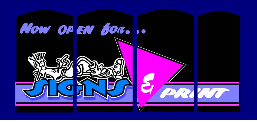

  • Terry Bull
    22 February 2004 at 11:42
    Just a suggestion Dewi
    kept the colours subtle though bright to tie in with the rest of the frontage
    Dont want to scare anyone
    Didnt know what your messages are so perhaps you can substitute
    Terry

    I think that looks fantastic Terry ! See what Dewi makes of it though 😀

    its got my vote too.. 😉 . not cluttered in the slightest, great impact and ties in with the colours used in the shop. doesnt come across as appearing too corporate/upmarket an image, more freindly & inviting! so joe public wont feel intimadated to stick his head in and ask for a price….

    THAT’S what I was talking about!

    Terry, that is excellent! As Robert said, it ties in with the overall colour scheme of the shop and makes it look so approachable! 😀 Has that been designed for the vinyl or paint approach? Either way, its highly doable, simple and effective lines, cool! Am I okay for using that overall design and layout Terry?
