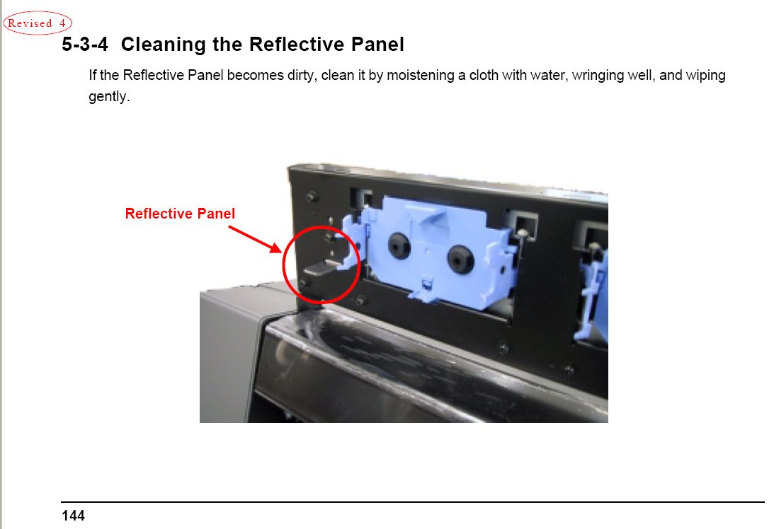

    It will be something silly as it doesn’t get heavy use, The only thing that springs to mind is the reflective panel, I’ll spend a day on the machine tomorrow to try and track the offending part down. I’m pretty sure that once aligned the machine stays aligned on the same power up, it’s only after the machine is turned off that the problem comes back.
    That said though the problem doesn’t seem to come straight back after it’s turned on, it’s gradual and over a little time that the alignment becomes an issue.

    We’ll i thought i would post back just in case it might help others in the future, I’ve been through the machine but couldn’t find anything unusual, there’s no play in the front cover at all and no sensor’s. The only thing that the manual says to check is the reflective panel on the front cover. After checking it the panel looked a little dull so i polished it back to make it shiny and so far so good, it must be used as a datum point for the Y movement so the carriage knows where it is in relation to the cartridge position. The sensor on the head (same one that reads the bar-codes on the carts) passes over this reflective panel (a little bit of aluminum).
    Hopefully it will last as there’s nothing else that it can be (apart from the machine not saving the settings after alignment)

    28 July 2015 at 18:21
    This might help you from the PC-600 service manual
    There are a number of reasons for not picking up the cartridge to be honest – check the reflective aluminium tag on the left of the cover to make sure it’s clean and polished (see earlier in the this thread), if when it proceeds to pick up the cartridge but it’s way off position and the head pushes the cartridge off then it will need alignment (steps in the PDF file attached). If it seems that it’s aligned but will not click in to the cartridge then it could be a problem cartridge case as I’ve had this on quite a few secondhand cartridges with no visible difference to one that picks up okay and one that does not.
    Cheers,
    Alex.
