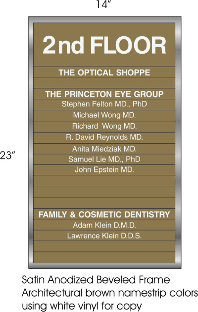

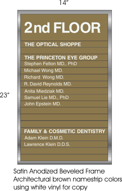

    which way would you lay this copy out (vinyl lettering)
    centered or justified left?
    can’t decide which works best….I know some of the copy might be too large (will adjust when directory is in my hands – am outsourcing)
    and should I be using a
    matte white?
    I think it would be a better alternative to a gloss because of glare
    this is an interior directory going next to an elevator (lift??? ๐Ÿ˜€ )
    thanks
    Leigh

    my personnal choice is centred it is kinder on the eye
    Lynn ๐Ÿ™‚

    I would submit both to the client and let them choose.
    My vote though would be left justy
    Ps matt would be prefered

    Personally, for the less informal sign I think centered is best. Perhaps if it were for a legal firm then left justified would be more appropriate.
    I would also choose the matte finish, it allows the viewer to see the text without any reflections or glare.

    I’ve made an awful lot of directories (or is that a lot of awful directories?), and generally the text would be laid out left justified. If someone is looking for a particular name it is easier to find in a left justified layout. Have at least the height of 1 slat as the left margin.

    I vote for Left justified. I agree itis much easier to read this way.

    I would definitely do it left justified.
    I would drop all text to about 85% of what you have here. The headings maybe even smaller, or perhaps same size but in bolder font… not bold bold, โ€œim all chunky boldโ€ :lol1: though… some slim font for the names etc and a regular font for the headers.
    The words 2nd floor same font too (as headers but bigger) but I wouldnโ€™t make it so big it could be centered. Ide have that running from left too with space to the right…
    Ok, my babbling is confusing me now; hope you can make some sense of that?
    Oh and if doing this… I like the idea of the matt, looks better on this sort of thing. One thing to keep in mind. I am assuming you have other floors? If so, they will want you to come back regular to change bits here and there?
    This being the case, use a difficult font to find. and maybe just use white gloss… reason?
    If you have to keep coming back for name changes on each floor, it means you will have to keep matt white or get it in every time. The difficult font to match is just to stop the local shop pinching your business. People get away with using โ€œsimilarโ€ fonts but when multiple lines of test together like this they wonโ€™t….

    You are def. right…..I couldn’t figure out what was throwing me off
    it’s the font and the size. I’m actually going with a condensed version
    (Helvetica….it’s what they already have throughout the building)
    gives it more height but less weight so to speak.
    Will go with a bold for the “2nd floor” copy and Heading names then regular weight for the Doctors names …… yah good???
