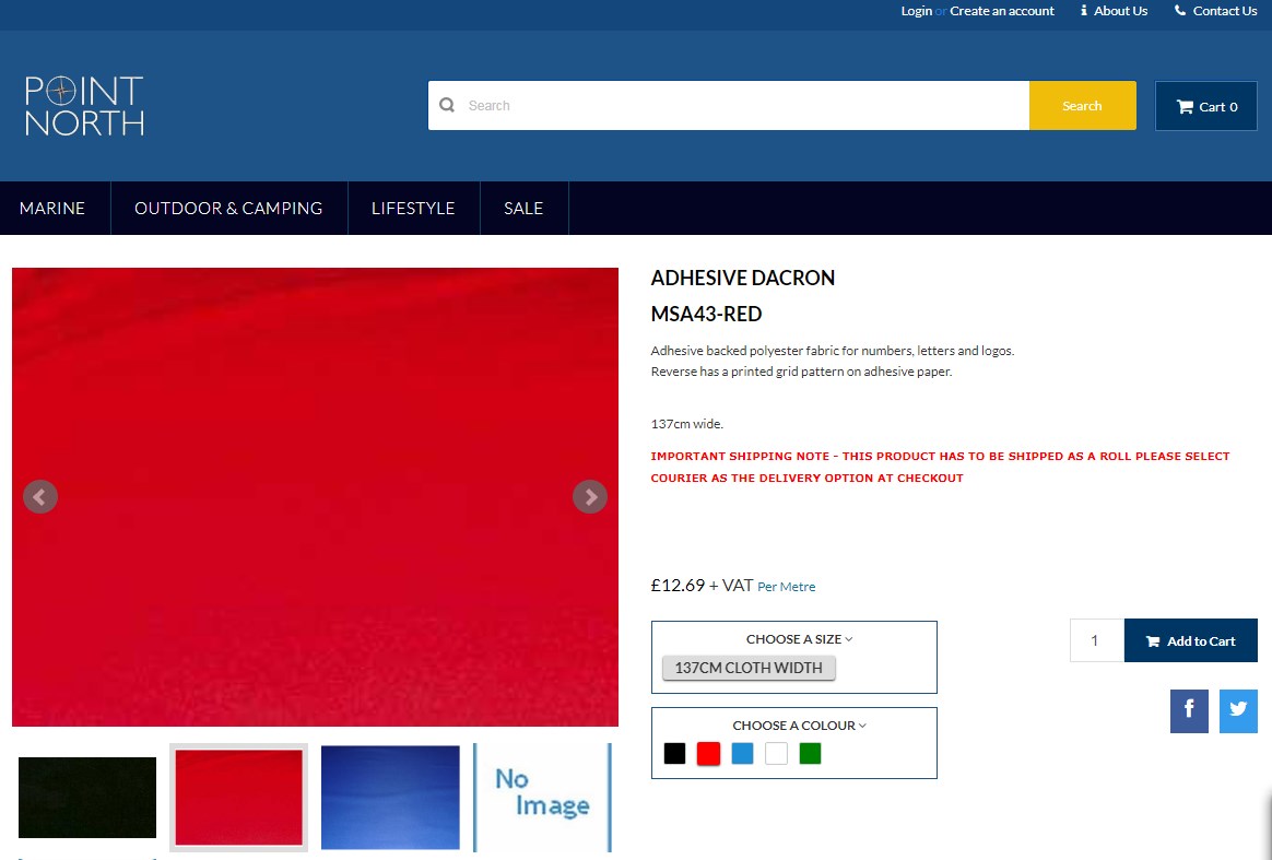

  • Pane Talev
    18 March 2019 at 20:02
    Can anyone please point me in the right direction where to buy (in the UK) self adhesive Insignia Adhesive Material in rolls?
    Need to cut and apply to a existing sail.
    Thanks.
  • Pane Talev
    18 March 2019 at 20:40
    Did some test cuts and this will work. Just need to locate these in the Europe. Otherwise must order from USA
  • Chris Windebank
    19 March 2019 at 08:45
    Hi Pane,
    I used a company in Portsmouth last time for the supply of vinyl, not sure but think Dacron rings a bell
    profabrics.co.uk
    worth giving these a call
  • Pane Talev
    19 March 2019 at 09:16
    quote Chris Windebank:
    Hi Pane,
    profabrics.co.uk
    Thank you Chris!
