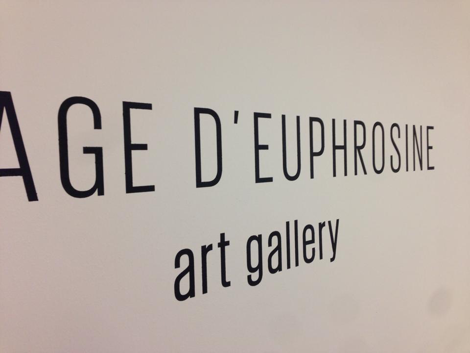

    little update guys:
    have used outdoor wall paint, this paint does not leak whilst drying, and gets really quick thick before drying.
    Hereby picture:
  • Tim de Beir
    9 March 2014 at 22:33
    did 1m with text, 3 layers stamped in 1,5 hour
