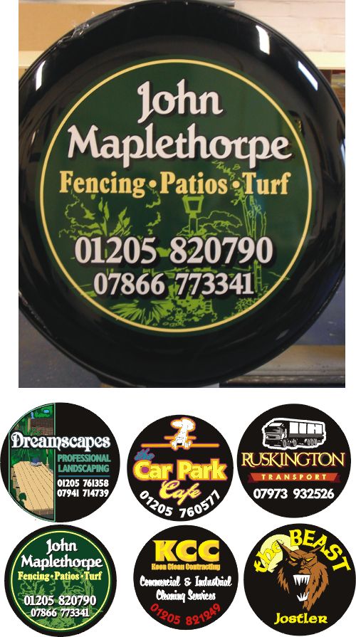

    Posted by Steve Broughton on 16 May 2003 at 16:53
    Heres a way to make a few quid, covers for spare wheels on 4×4’s are mostly unused but are a good place for signage and they don’t have to be just boring old text, you can make as much of them as you wish, they are available from either http://www.wheelcover.com or victory-design.co.uk for about 30 quid, design them up and I sell them for around £110, if this sounds expensive to buy a replacement one from a dealer with the dealers name and adress on costs about the same.

    Steve,
    These are great! what vinyl do you use to put on them? Just normal vinyl eg Mactac 9800,…?
    Gav
  • Mike Brown
    16 May 2003 at 20:49
    Steve – what a fabulous array of wheelcover designs…
    The Maplethorpe one looks even more impressive in real life – so I can only imagine how great some of the others looked when made-up!!!
    My eye is particularly drawn to the dreamscapes one…was that cut vinyl or printed? – it’s beautiful!
    Great idea, very reasonable prices and some great examples too – more please. 😉

  • Steve Broughton
    17 May 2003 at 08:16
    Gav, yup ordinary vinyl but the covers are the ones with the hard plastics discs not the soft all vinyl ones.
    😳 Thanks Mike, the Dreamscapes one is all vinyl, I did it soon after reading your demo for the Parker van? Dave Westhall, is the bloke that owns Dreamscapes, gave me a few photies of his work and this is just a section of a japanese garden that he did for someone. Pity he’s only got a 4×4 as it would look great on a van, I told him if you buy a van mahe sure its a dark colour 😆
