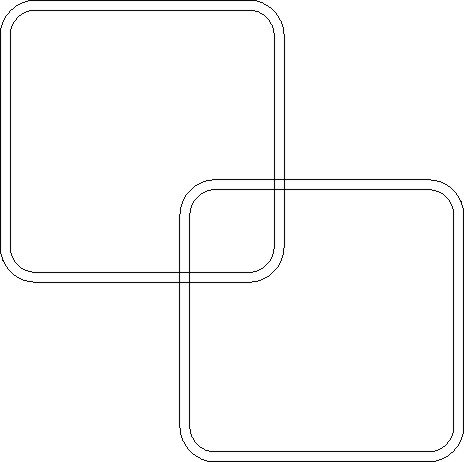

    Having real trouble with this and it should be so easy.
    As you can see attached i have 2 boxes overlapping all i need to do is to weld them together so that they don’t have the crossovers so that they don.t cut thorough each other.
    I ‘ve seemed to have tried everything but just cannot do it.
    Can anyone help me please, using coreldraw 12.
    Thanks Dave

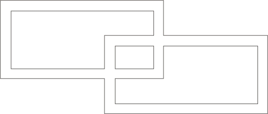

  • Chris Wool
    14 April 2008 at 15:36
    like this
