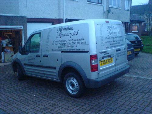

I actually have a heat gun but i bought the steamer today to be on the safe side.
Couldn’t find one of those polypropylene chisels so I went for a tough squeegee.
for the first few letters i heated and scrapped; it was tough and it left allot of glue but after a while i realised that by heating as many letters that the attachment would cover and scrunching up a corner of each with the squeegee I was then able to get a grip and one by one they peeled off.then it was the next five or so letters.
tar and glue worked a treat
Still got some more to do and then its the reapply.
thanks for the ideas.
Jimmy
you’ll see it when its finished.
The customer wanted allot of lettering so that’s whats taking the time 🙄
