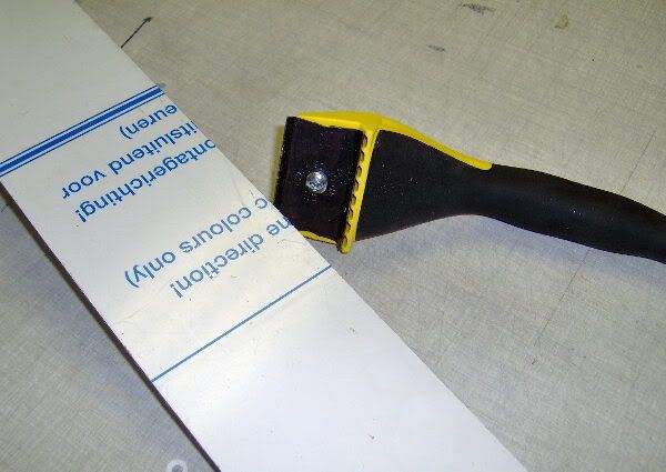

    25 August 2008 at 15:29
    Turns out the tool I use is the same as Nick has mentioned
    Here’s me in action – deburring. What I like about this tool is it’s very quick. A single stroke and the edge is safe. No need to spend a lot of time filing
