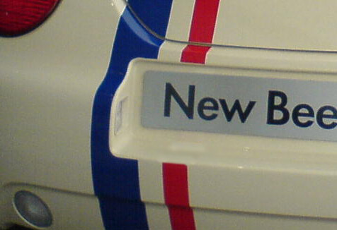

    Hi Gang, hope you all had a good’un!
    what would u charge for this, 2 stripes front to back fitted?
    havent done one of these yet.
    cheers peeps

    It looks deceptively easy but can be very time consuming. Consequently charge about £150 + VAT or it’s not worth doing.

    any tips on how to fit the strip into the back numerplate reses? 😮 how the hell am i going to ‘mould’ it into that?
    u might just be able to see from the photo

    del id take the plate off and run under, looks like you might have a little cut and shut to do there – use a cast vinyl for the curves amd maybe make a template first

    As u you see from the photo the number plate recess would be practically imposible to do in one piece, even in cast material. There is also a light in the side wall of the recess which doesnt help. If you definately have to go into all the nooks and crannies a pre-mask template then cut the inserts. Dont think the number plate is you biggest issue, the compound curves and extreme angles are.[/img]
