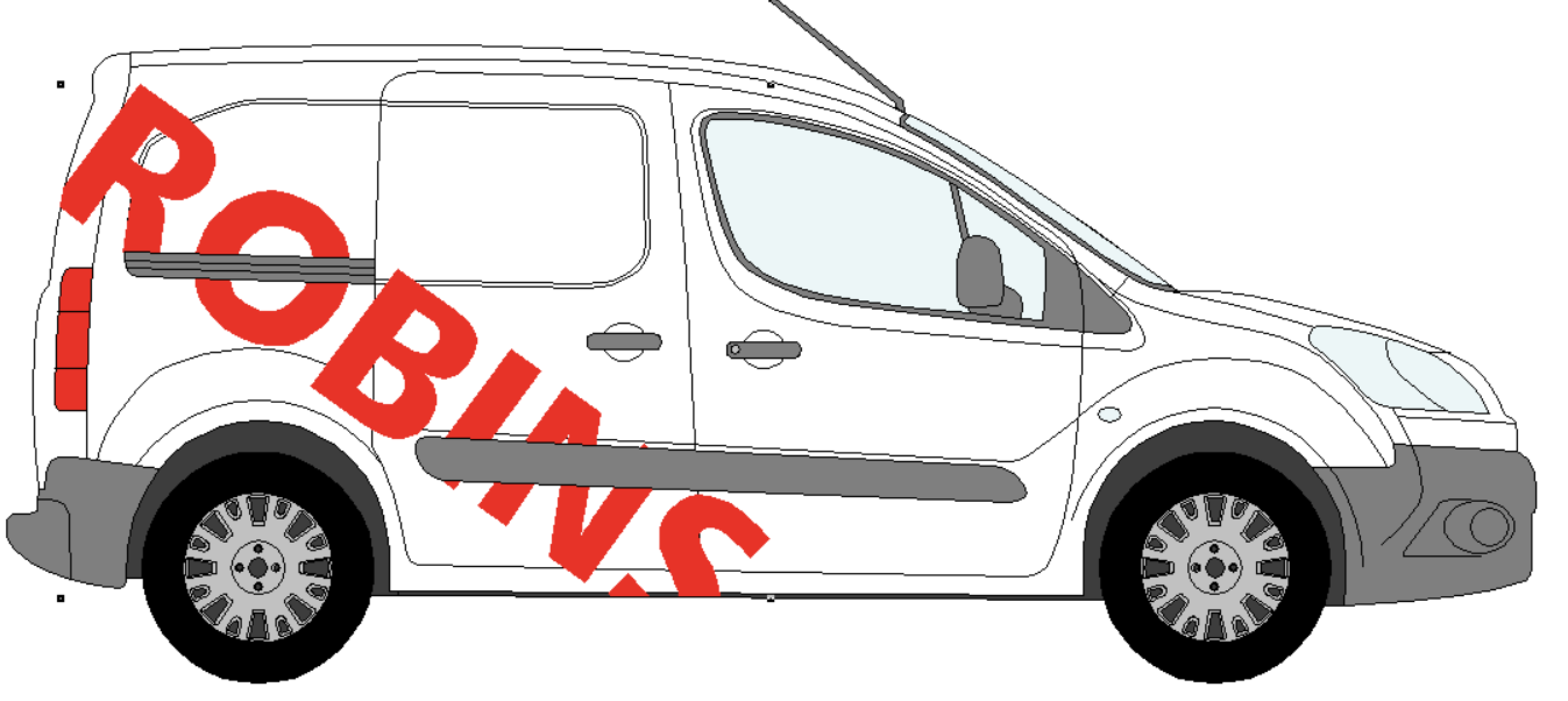

    Hey
    Just to get a little feedback, what vinyl would you use for the design in the attached image?
    Bearing in mind potential issues with the vinyl popping out of the recess at a later point.

    28 July 2016 at 16:26
    Oracal 751 will do that as it’s a cast, but there’s not much in the recess, and from memory they’re not that deep.
    You may be OK with a decent polymeric, if you work the vinyl into the step, not stretch it.

    28 July 2016 at 18:27
    Decent polymeric layed over the edge with no stretch. Have done on a few occasions and its been fine. If i had red cast on the shelf it would be my first choice tho!!!

    28 July 2016 at 19:00
    3M 180C
    28 July 2016 at 19:29
    This should be easy enough to inlay into the recess. So based on that Oracal 551. Other wise Oracal 751c.
  • Daniel Evans
    28 July 2016 at 20:05
    Thanks guys.
    I was planning to use 751 but I do like avery vinyl so I was thinking maybe the 777 although I have not used that before.
    Never used the 3m 180c and don’t even know how that compares on price with oracal and avery, i’m guessing being 3m will be a lot more expensive.
    It’s good to know what others would do and what their weapon of choice would be.
