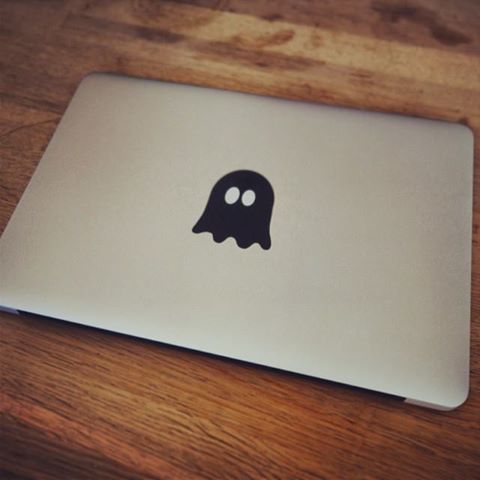

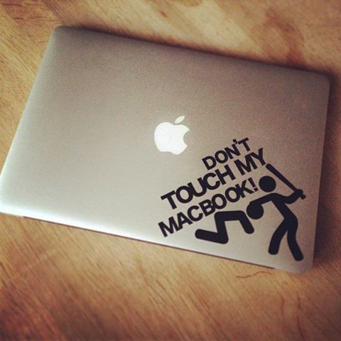

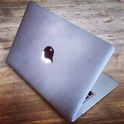

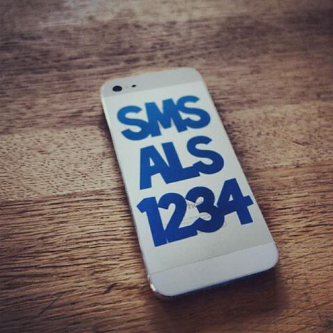

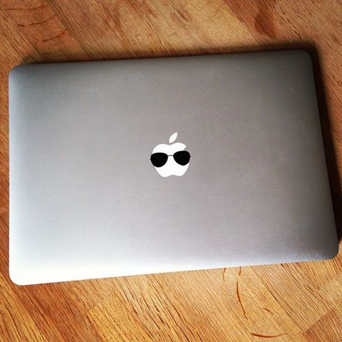

    Here’s the specs:
    – Cast
    – Matte and in many colors. (at least, blue, pink, green, white, black & red)
    – NOT car wrapping vinyl
    The reason I’ve put in not car vinyl, is that they are too expensive, and too thick.
    I’ve tried the 3M Scotchprint Wrap 1080, and besides being too expensive, it’s also so thick, that it’s hard to peel small details < 1cm. Makes sense since it’s a car wrap film I guess 🙂
    So, any suggestions out there?
    I’ve attached some images of my products, so you can get a better idea of what I need.
    Thanks a bunch!

    Just contact the vinyl suppliers in your own Country & ask for cast vinyl swatches, all the main manufacturers do a cast but the range of colours available is a bit more limited if you are looking for matt as opposed to gloss.
    Some of what you have shown there could easily be done with a good quality calendered vinyl as well which would reduce the purchase costs. Same would go for the range of colours available though, more gloss colours available than matt.

    What would a great quality of calendered be?

    Hexis S5000 would do everything shown in the pictures very nicely and at a reasonable cost per meter, or they do a S10000 Cast material but cannot see why you would need that for what you have shown.
