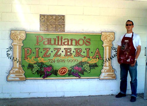

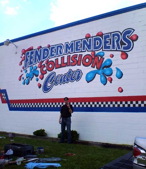

    I always use a mix of 1-Shot Lettering and Bulletin enamels.
    To extend drying/blending time you can use Smith’s Creme.
    (not really a cream, more of a liquid)
    and they do sell a flattening paste to add to your paint to reduce gloss.
    1-Shot also has a mette clear, which I’ve never tried.
    I’d be leary of acrylics fading or not standing up to the elements.
    Here are two we did last year, it still looks great, 100% 1-Shot.
    It typically takes 4 years to fade.
    By then you can start calling it a "Ghost Sign" to sound trendy.
    Love….jill
  • John Singh
    24 April 2006 at 21:51
    Hey Jill thats great stuff
    Its got WOW factor
    What a pleasure to see
    Marking out on walls is a real pain
    I guess they were pounced!
    I’ve done walls they seem to take an eternity compared to nicely glossed surfaces
    Thanks for sharing

    Jill, those murals are amazing, wish customers here would pay for that quality.
    Apologies AJ I doff my hat to Jill’s superior knowledge, I have never used 1-shot. Wish someone supplied it here, sounds like great stuff.
    How much would you charge for the top one Jill?
    25 April 2006 at 12:00
    I think I got $600 for painting the word "Center" and re-painting the entire thing. (3 people 10 hours, $ split 3 ways) We did use a pounce pattern for Center.
    (messy divorce, had to change Benders to Menders due to a dissolved partnership)
    This was not my design, and the owner masked & painted the checkers.
    To do it from scratch I would have charged in the neighborhood of $1500.
    The bottom one I did WAY too cheap, but I was trying to get my name and services out to the community…$250 and it took about 8 hours with 2 people.
    This job has gotten me lots of referral work. Everybody asks if I did it.
    This was projected the night before…you shoulda seen the bugs on the screen!
    I have also done ones using a small drawing blown up with a grid system (easier than you think)
    The job I’m bidding right now consists of 2 walls 15’x30′, a 15’x15′ front and back, and possibly even a wall. I bid that out at just under $7,000.
    They gave me a $250 design fee which I will deduct from the final payment.
    Do not be afraid to ask for what you are worth. Wall painting is a very specialized skill. It’s kinda fun too.
