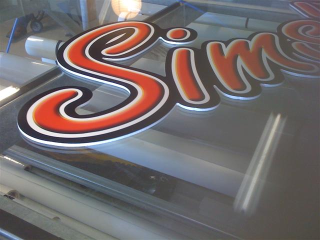

    Anyway here is a visual of how it is supposed to look, and also a pic of part of the logo cut in 6mm dibond. Its actually very good stuff, and very strong too. Pity about the core.

    Simon sorry for questioning your knowledge but from the photo posted that sheet looks more like foamex than composite is it deffo a plastic aluminium sndwich panel? 😕

    Yes John it is a plastic-aluminium sandwich. I think the white edges spoil the shadow effect somewhat, but it is acceptable. The usual 4mm we use has a black core but is not strong enough for the sticky-uppy bit – we get wicked north west winds round here during the summer that blow for days. We are using 4mm for the BAKERY part though.
