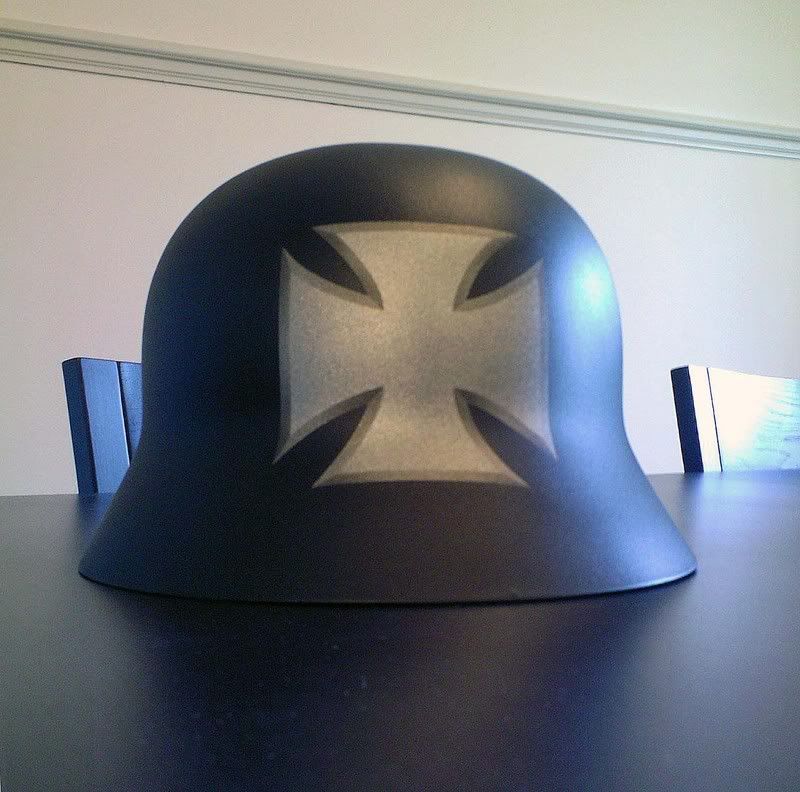

  • Jeff_Brown
    18 June 2007 at 13:58
    This is one I am working on now…
    One i finished a while ago..
