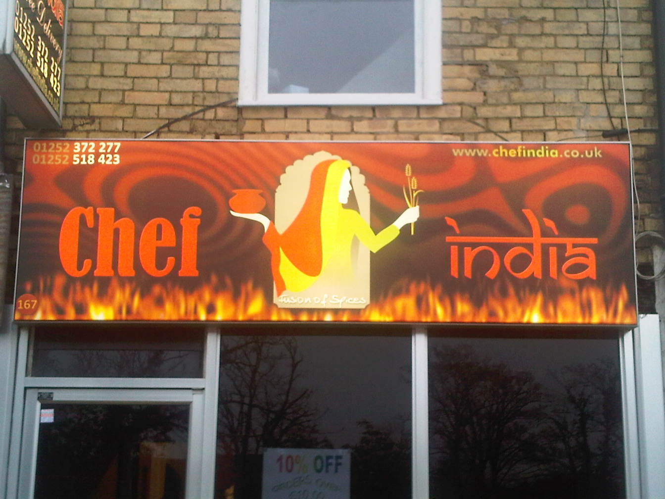

    Hi all,
    I have been asked to changed this light box over to a new design, on first looking at the box i thought it was opal acrylic as usual but this one seems to be a stretched banner which enables light to pass through. Not sure if i’m up to speed with new technology these days but this is the first i have seen of it.
    Does anyone know a supplier who can print his?

    I think it’s called Flex Face.
    I had to letter one of those last year.

    there is around 9 suppliers of flexiface on the UKSB Toolbar
    the trouble is, your customer wants to change the skin, not the full thing. there for you MUST identify the flexiface system being used and then buy from that supplier. one tensioning system will not fit anothers box.
    to identify the system you will need to unscrw one side of the box that will expose the tensioning system.
    take a picture and post it on here and someone might be able to identify it.
    personally, unless your going to be making plenty, or know exactly what your doing and all involved. i would decline doing it.
