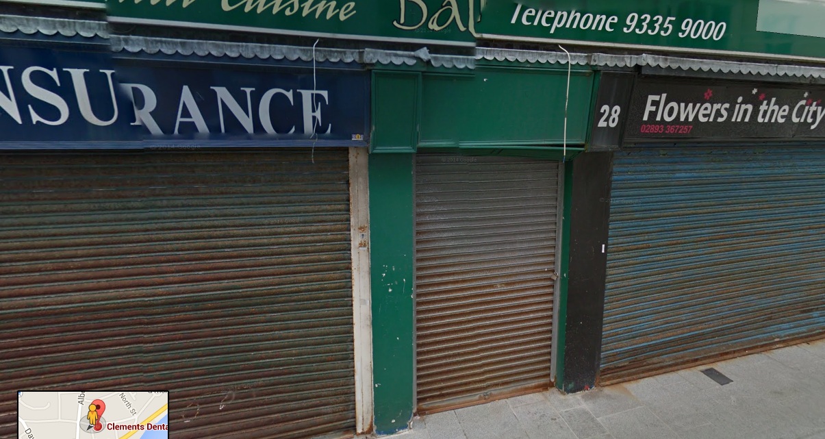

    Thanks for replying James and Martin, yes im the same as both of you i would be doing it in horazontal panels and trimming in, we are skilled enough but i have said the exact same to the client as you said martin about the prep of the shutters, i said that if they just send a painter down to give them a lick of paint then its a waste of money exercise as our wour will pull off and bring the paint with it. so they have been told to get them properly tidied up ie powerwash and scrub, remove any rust or corrosion
    here is an example of some of them, they arent in great shape

    Because the best bit of advice i can give is to run as hard in the opposite direction you can from these shutters. 😕
    no matter what vinyl you use, the surface has to be perfectly prepped or the vinyl is coming back off.
    the only shutters i would think about applying vinyl to is the plastic coated modern ones.
    quote John McNickle:
    Would you use a premium polymeric or go cast, the inlay isn’t that deep when installed, remembering local councils always want to keep costs down
    Even rubbing those shutters down is going to be very time consuming exercise, then priming and painting them. then vinyl on top? its not an easy job and the state of them says it all. every time you open and shut them they will rub against the vinyl and start taking the graphic off. when it starts coming away they will be on the blower asking you to repair it.
    joking aside, i would advise them to have the shutters rubbed down and painted. if they want something on them then get a guy in to air brush or paint some generic shapes on them.
    just keep in mind, they are curved, steel, cold metal shutters. vinyl wouldn’t want to adhere to them in the best of conditions, never mind like that. do not get me wrong, i know there are folk out there doing shutter wraps. there is one done a less than 100 yards from our unit. but the shutter was new and i’m guessing it has the plastic coating on them.
    anyway, i know its a council job and the prospect of more jobs from it maybe on the cards. but i think you giving them blunt honest truth and maybe your best option mate.

    After seeing the photos I agree with Rob. I wouldn’t be able to find a barge pole long enough
