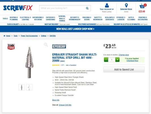

    8 August 2025 at 19:42
    Perhaps try a step drill bit, like this.
    https://www.screwfix.com
  • Mark Johnston
    10 August 2025 at 23:14
    thanks for the reply david.
    what does a drill like this do that a normal drill doesnt?
    i thought these were for drilling different sized holes using one single bit. 🤓

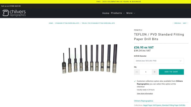

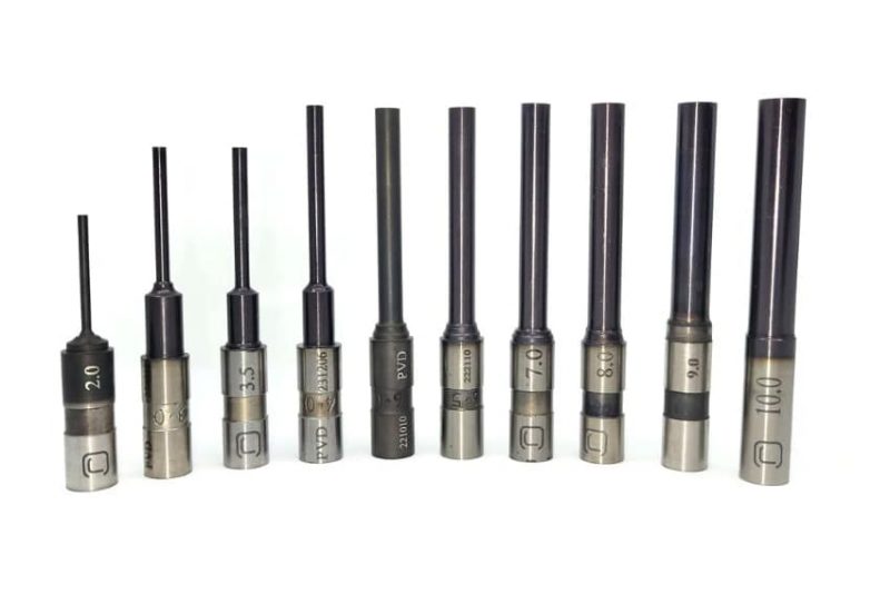

    11 August 2025 at 12:56
    We use paper drill bits for Correx and Foamex (not ACM), and they work brilliantly. I was sceptical at first about how long they’d last, but they perform really well and cut perfect holes.
    https://www.chilvers.co.uk
    (edit. Sorry Mark, doesn’t answer your question at all, but I thought it might be useful anyway!)
