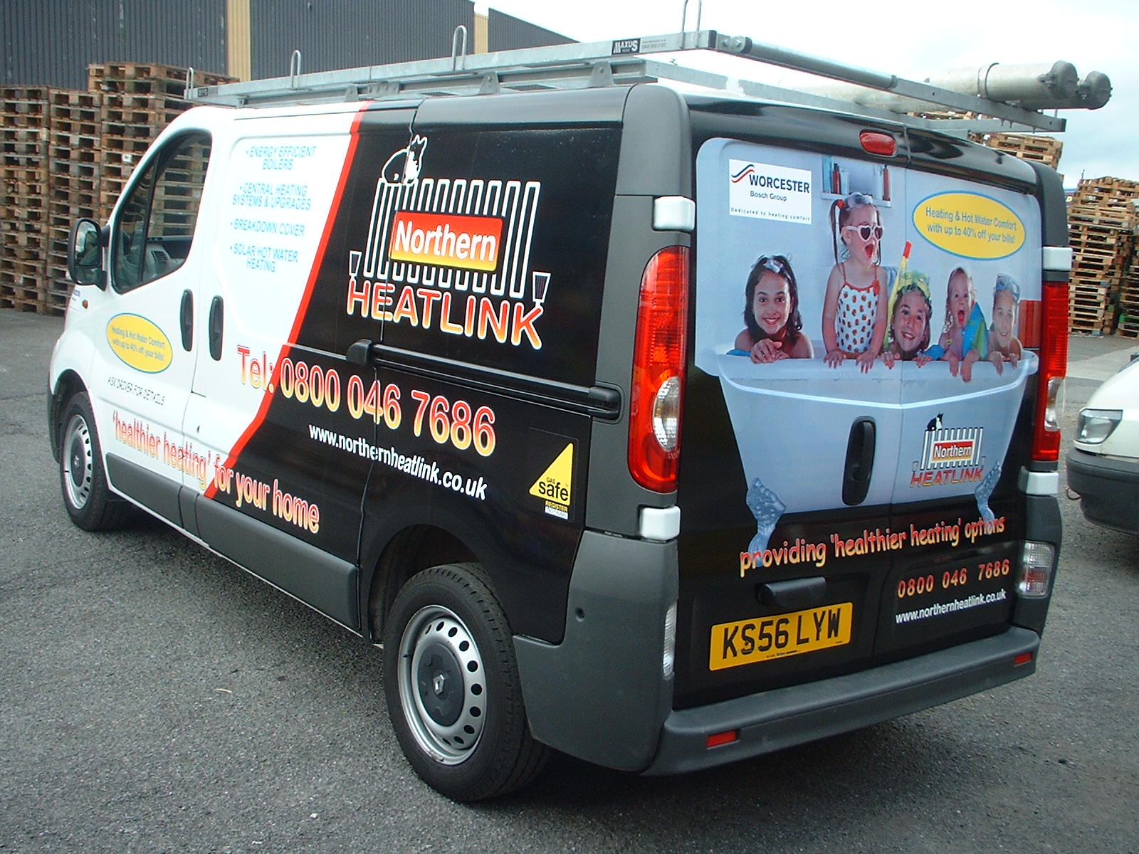

    10 October 2009 at 13:38
    This was done using a 30" Cadet.
    Whilst not ideal – it can be done, and the seams are actually less noticeable than you would expect because of the print pattern. The downside is that using a 30" machine makes the job more difficult than it would be if using a single sheet to cover an entire side.

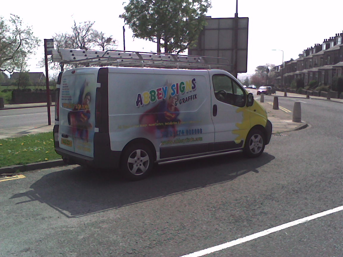

    10 October 2009 at 13:49
    Hi phill, yes i would probably agree, i can imagine using a larger machine would ease things, however, it is probably easier to handle the media from a 30 inch machine rather than a 54 inch machine.
    Saying that, if you did a vauxhall vivaro for example even with a larger machine you wouldn’t be able to cover a full side without any joints so i can’t always see the benefits of the larger machine…
    These were also produced with a 30 inch machine…
