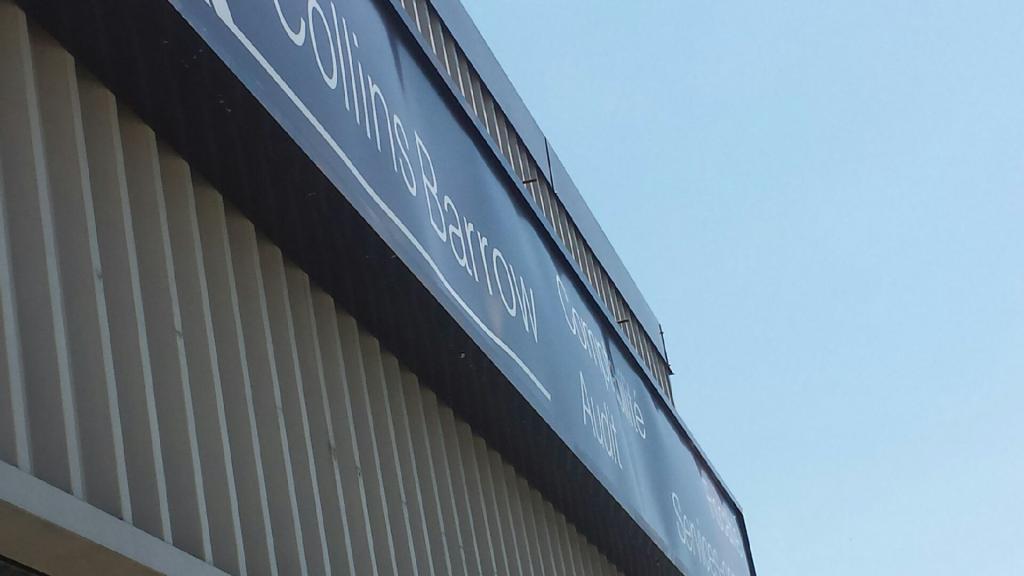

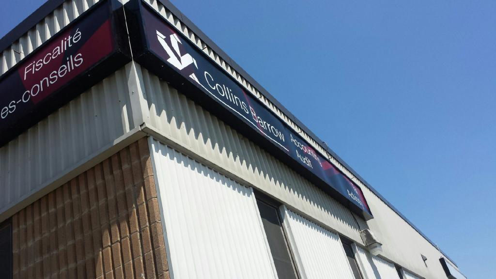

    Does anyone have suggestions about what might cause the sign face to ripple like this in the frame?

    It’s Lexan or Makrolon polycarbonate.
    Would it be a space issue due to expansion on the height and width or from the depth(so the face is being pinched at the front on the retainers)? Or both?

    Maybe I wasn’t clear either. This is a backlit sign box with LED lights. It’s not in panels. It’s one full 25ft length of Lexan (translucent white plastic).
    With printed/laminated vinyl laid on top.
