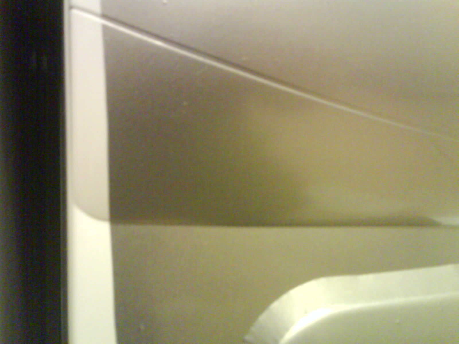

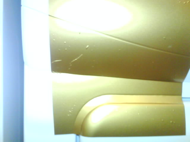

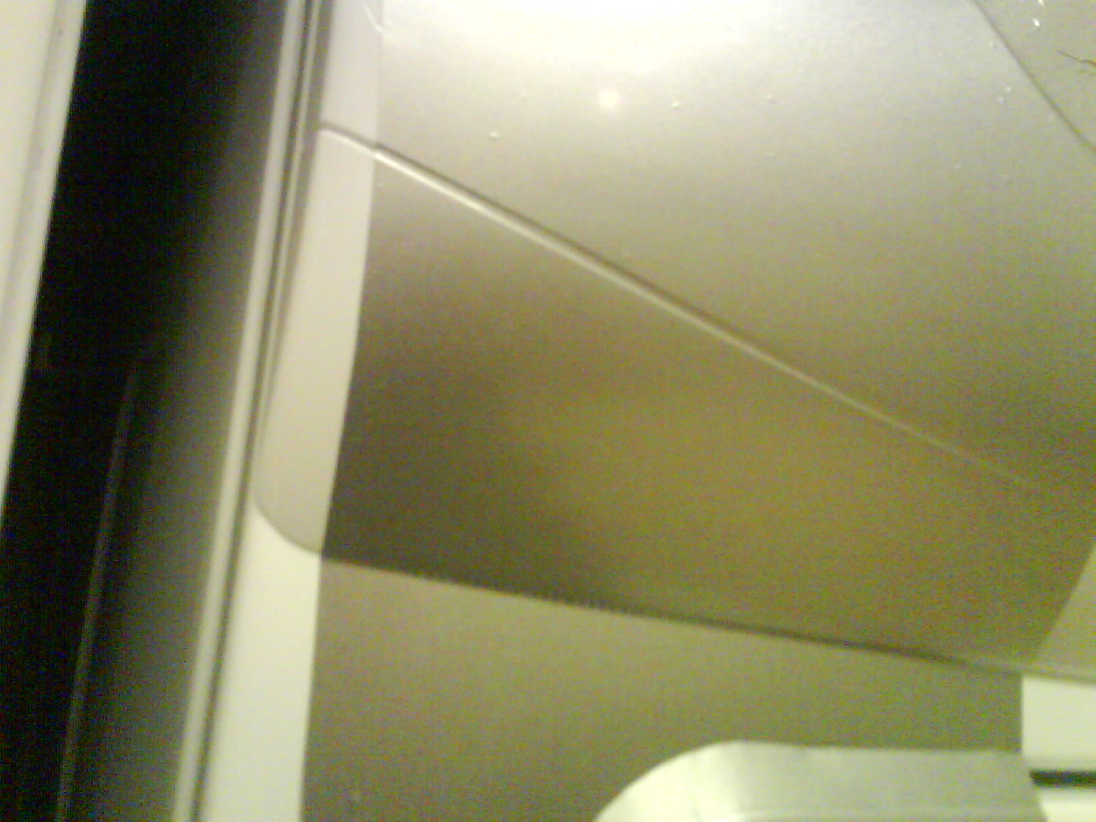

    Well didn’t turn out so good this time
    I tried this surface on the washing machine and you can see the results
    the surface was curving to left and top to bottom and so i keep getting a crease like there’s to much vinyl for that area.
    should i be heating vinyl for this kind of surface?
    what am i doing wrong?
    Lee

    Its Oracal 751
    It is only a 8" square bit of vinyl
    I just tried it again and did it from the bottom up and now the crease is at the top, its when i start getting towards the end.
    Its kind of like trying to apply vinyl to a ball
    Lee

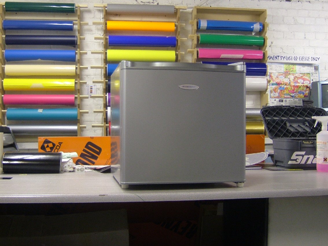

    Lee be careful using the heatgun on your washing machine. .. most of the insides are plastic. . you might get a nasty surprise !

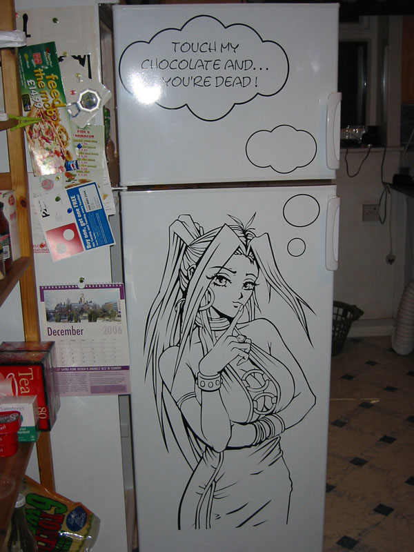

    On the subject of kitchen appliances here’s my fridge ! :lol1:

    I just had another go and i think the application tape was a big part of it .
    Its turned out a lot better this time.
