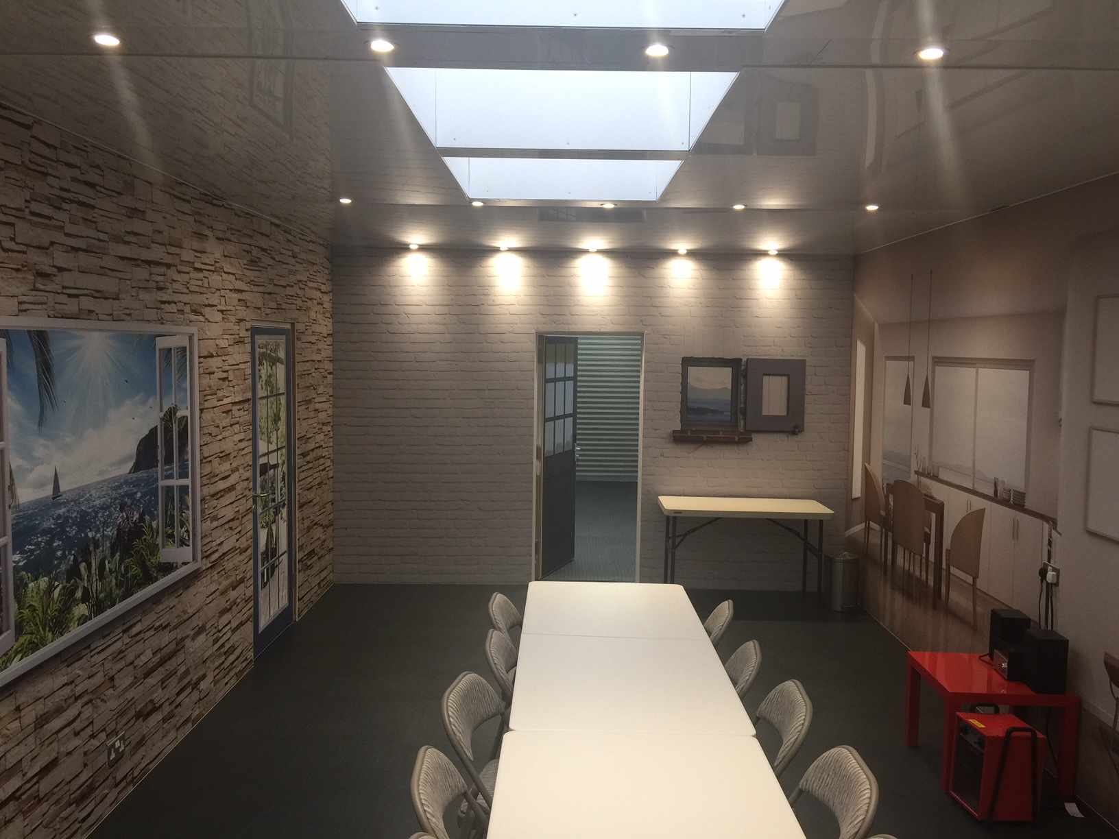

    1 piece fabric can be fitted around switches and sockets etc no problem
    something like this one man half day
    first pic is a room we built in the back of the old unit

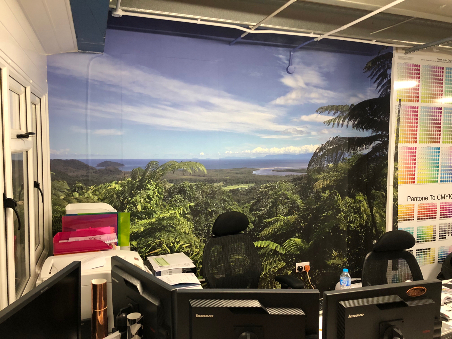

    14 March 2018 at 22:21
    Just did this one on our office wall, photo taken on iPhone 6s last year in Australia, printed with our 26500 onto Avery film. Canvas like finish.
