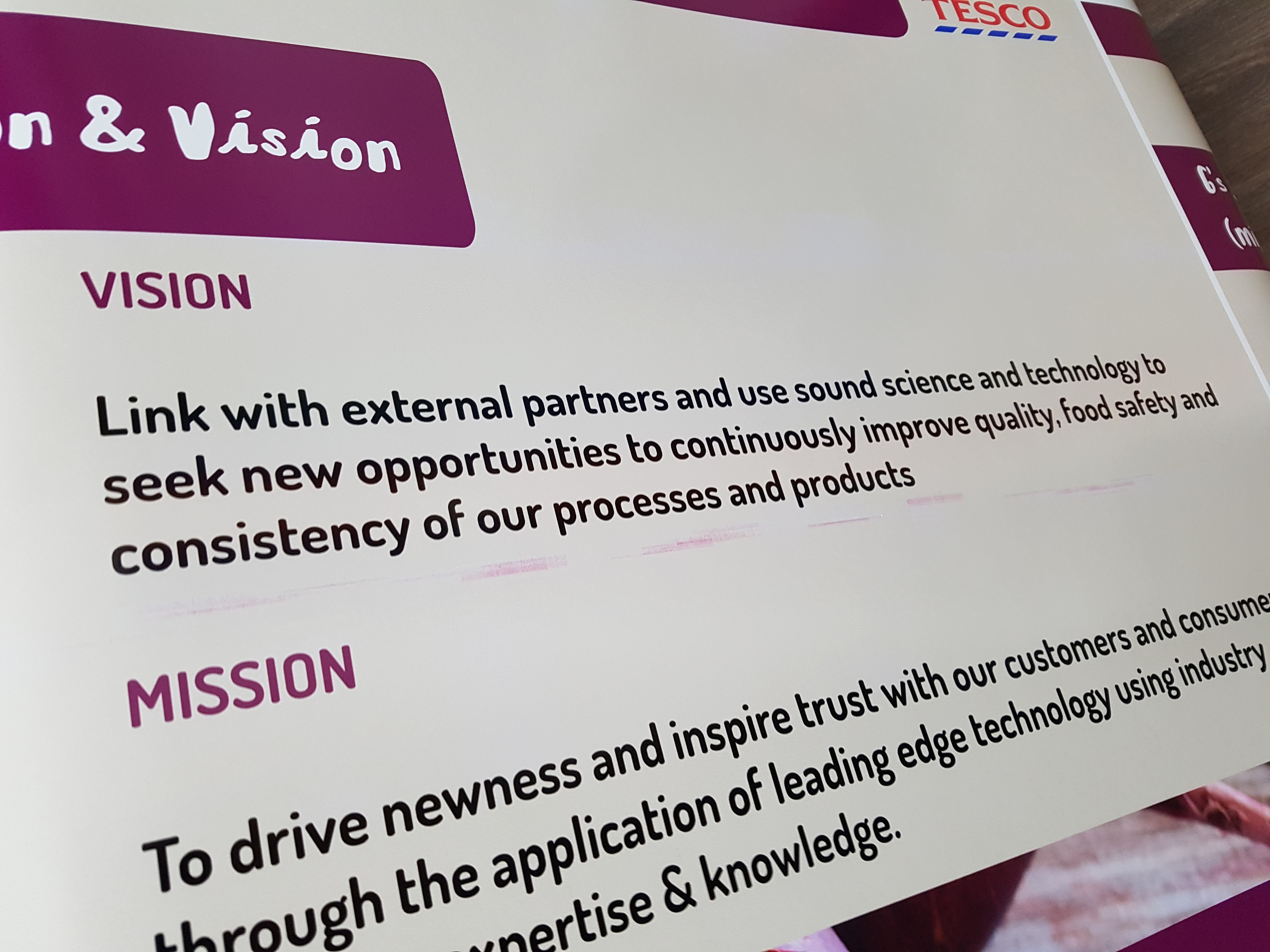

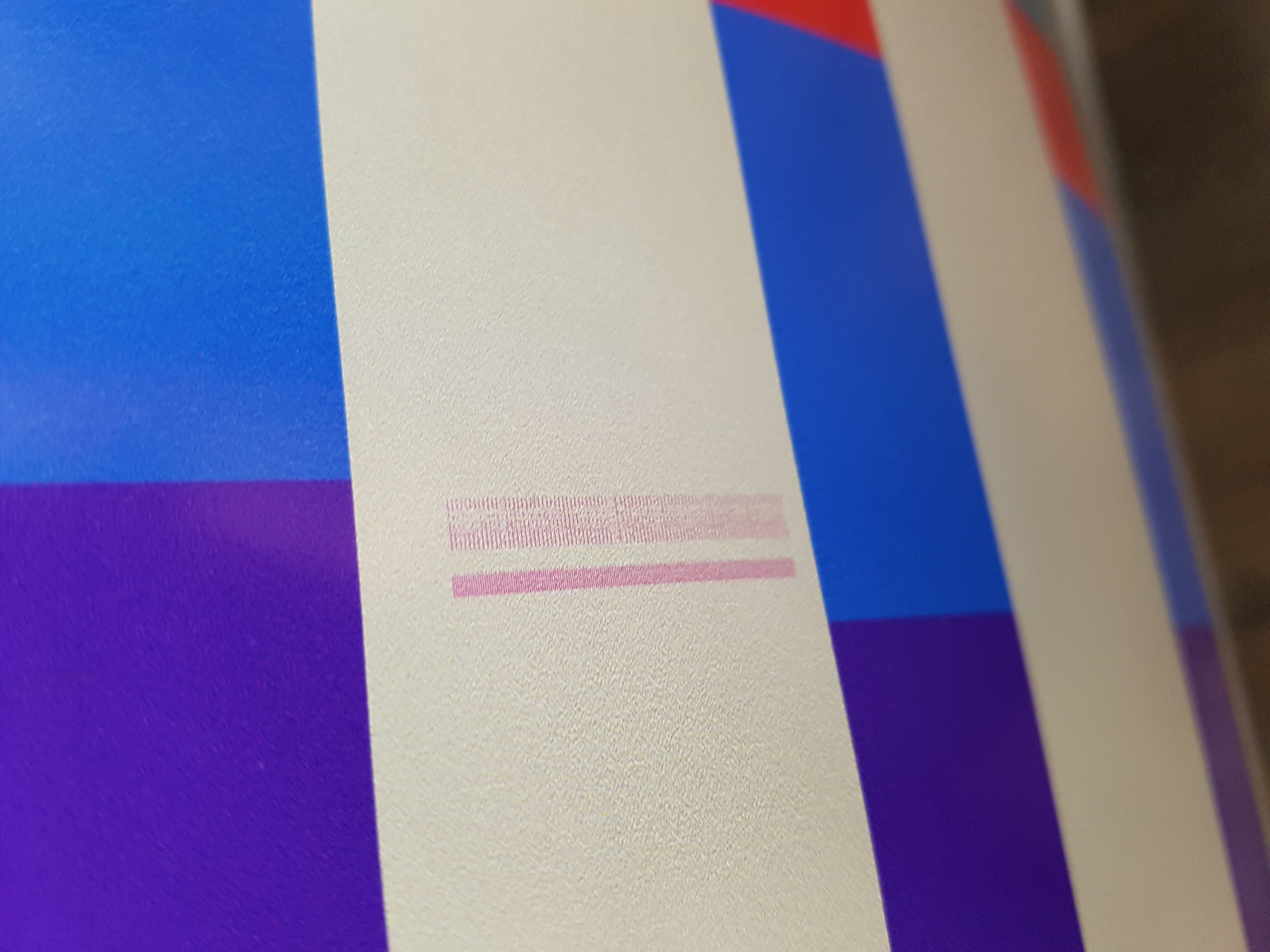

    Hi Chaps
    Any ideas whats causing this? pulling my hair out. Nozzle print is fine and I’ve tried diff network cables and even a diff PC so thinking its def a printer based problem.
    Its not started overnight just one or twice over the past few weeks and now its every inch or so.
    Im hoping its not the main board and a simple fix
    any help or ideas is much appreciated
    Thanks in advanced
    Robert

    I hate to say it, but that’s got me stumped!! I would guess at printhead but it would be a guess. It’s probably worth starting with the cheaper stuff like head cable and working your way through it.

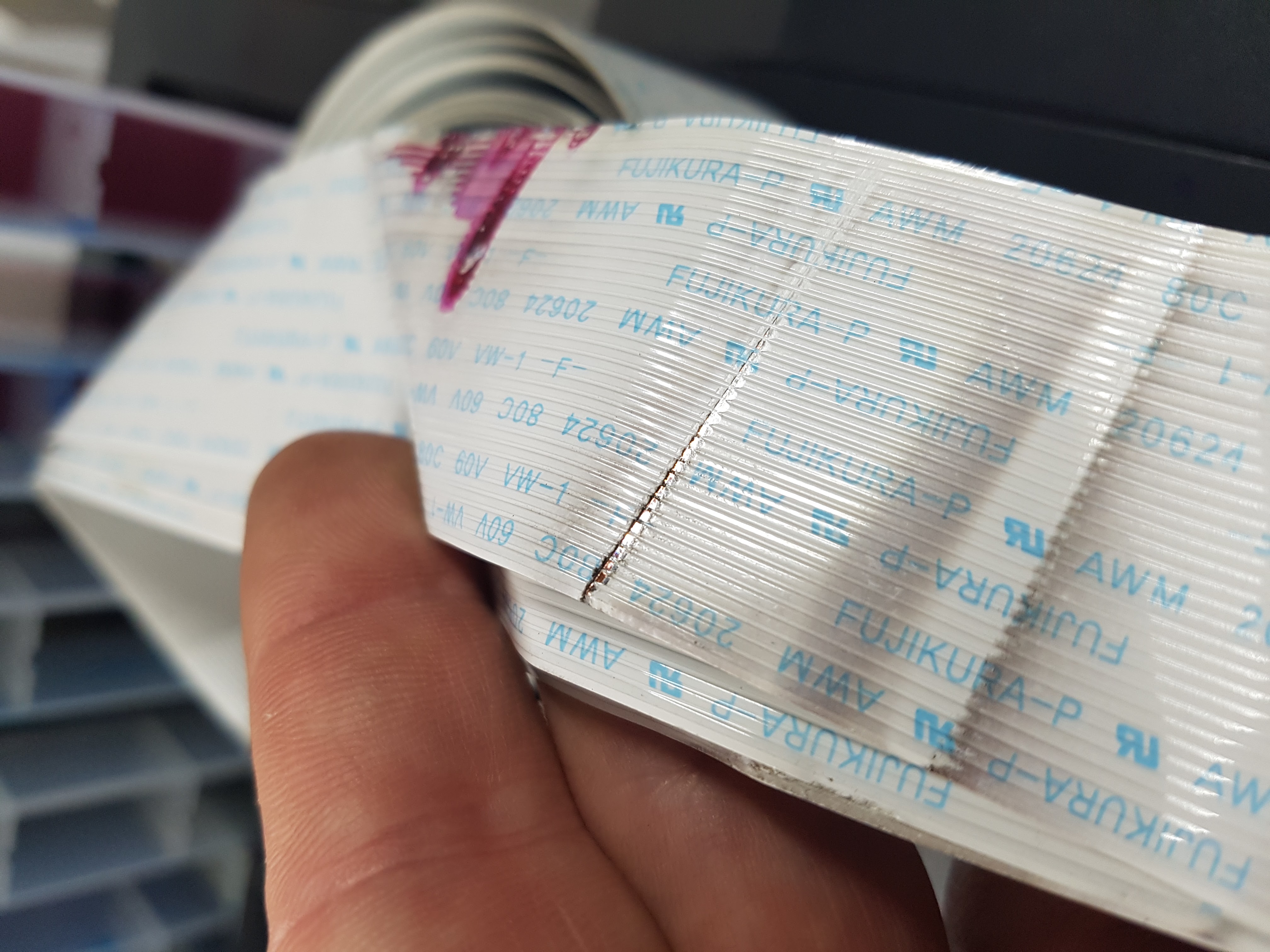

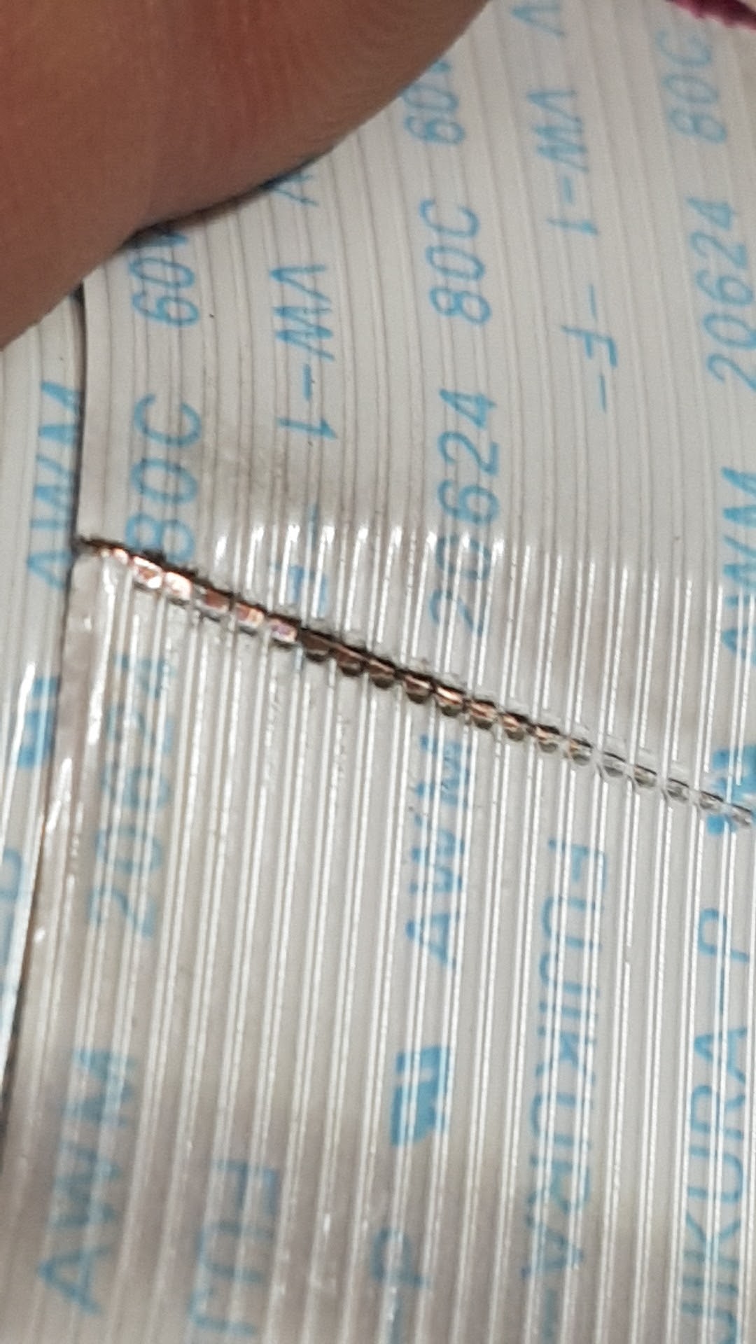

    Just a quick update, seem to have found the issue.
    one of the head cables worn through, new one ordered and fitted but managed to
    upset a damper when I was fitting the new cable 🙁
    so new dampers ordered hopefully happy days
    Cheers for the help Stafford

    23 July 2017 at 15:58
    It was near the head side of the ink and cable chain. The metal support that’s sandwiched between The cables and ink lines was protruding past the plastic supports
