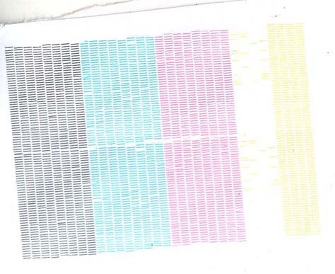

    I was printing when suddenly there was a change in colour so l stopped the print and decided to do a head test print. The yellow head is firing half way. I have attached a jpeg format of the test print so you get the idea. Any ideas pls[/b]

    Hi Ernest
    Pls check your damper or capping.

    thx bro,
    All solved, it was my head manifold, it was broken.
