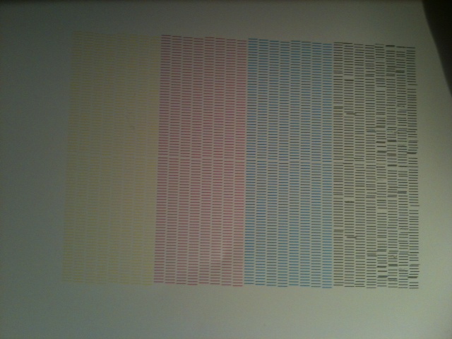

    My trusty VP seems to have developed a fault with the black head. All the other heads are firing fine. I’ve cleaned the heads manually, the wiper blades etc as well as performimg a couple of power cleans with no change. I always check the test print and it was working fine last week. Any suggestions greatly appreciated.

    Try clamping the pipe that goes from the cap to the pump (use a clothes peg or freezer bag clamp thingy) then fill the cap with cleaning solution. Let the printer sit idle for a couple of hours then do a couple of powerful cleans.
    To be honest with you, I doubt it’s anything to do with the cap or pump as they’re common to both black and cyan and your cyan is fine. I would look head or above, i.e damper, cartridge….

    Thanks Stafford, not had issues with any banding. I’ve done a few extra normal cleans now as the power cleans just seemed to be dumping enormous amounts of ink with no effect.
    The print is better with the black, I’ll look at soaking the black head for a few hours today. I have been away for a few days, left the machine on but perhaps a few of the nozzles are blocked.

    Thanks both, I’ll play about with my feed but I have never had printing problems onto Metamark which is the only vinyl we use. Head soaking now, I have maintenance cover but I’m assuming it does not cover the price of a new head?
    I soaked it for an hour and tried it again with no change really, but it is printing at an acceptable level. I’ll try soaking it everyday for a couple of hours to see if it helps, will keep you informed.

    Depending on how confident you’re feeling, you could try back flushing the head (take the damper out, put a syringe on it and pull air back up through the head) but obviously you would be doing so at your own risk. Otherwise, it might be time for a new printhead.

    Just an update. Engineer visited, very professional, black head changed. Stafford, you were right, heads need calibrating. Completed manually, capping stations replaced. Excellent all round. I have now upgraded my cover to cover two heads per year.
