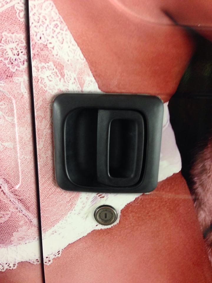

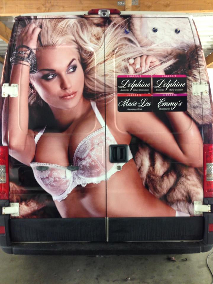

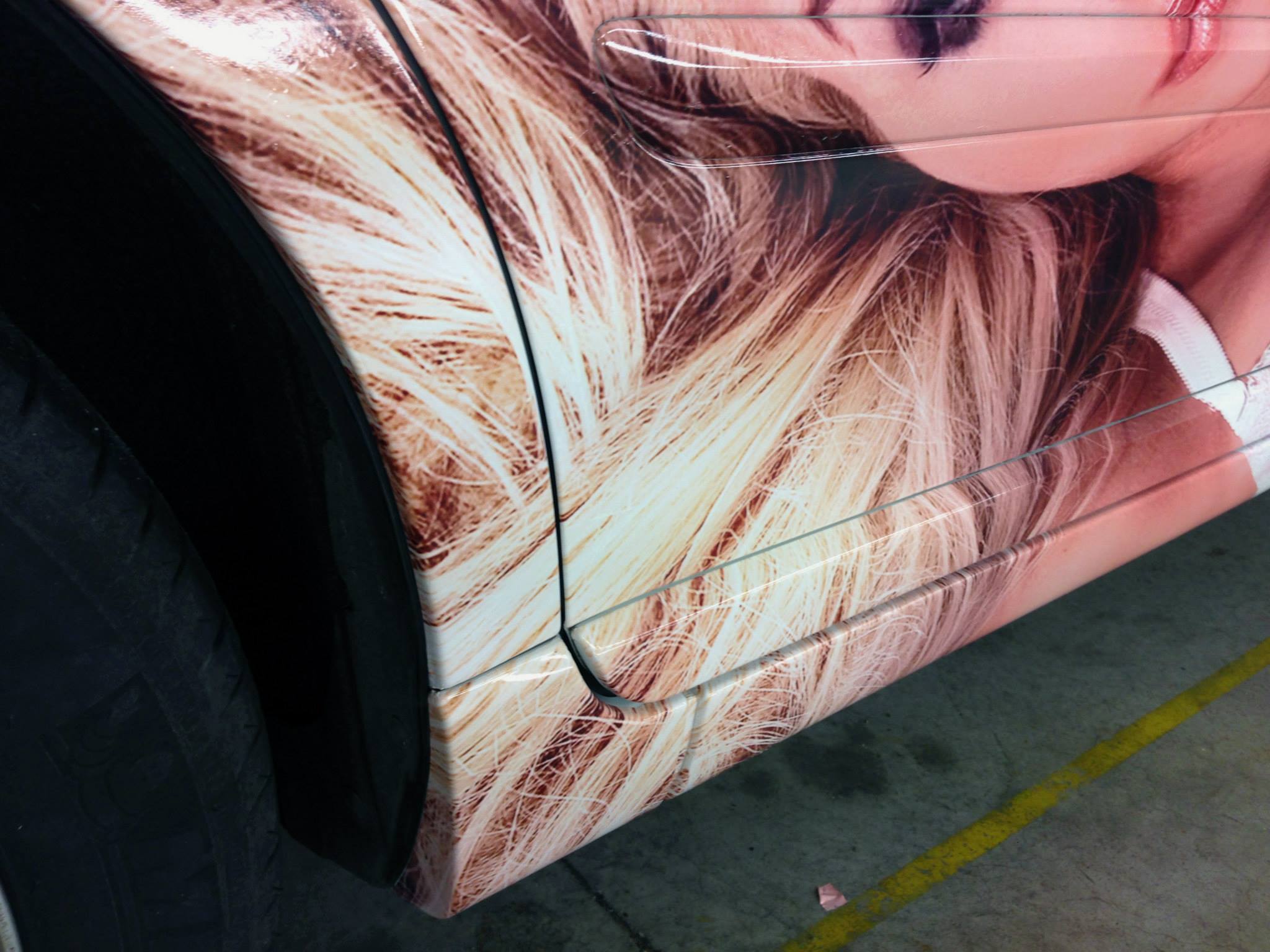

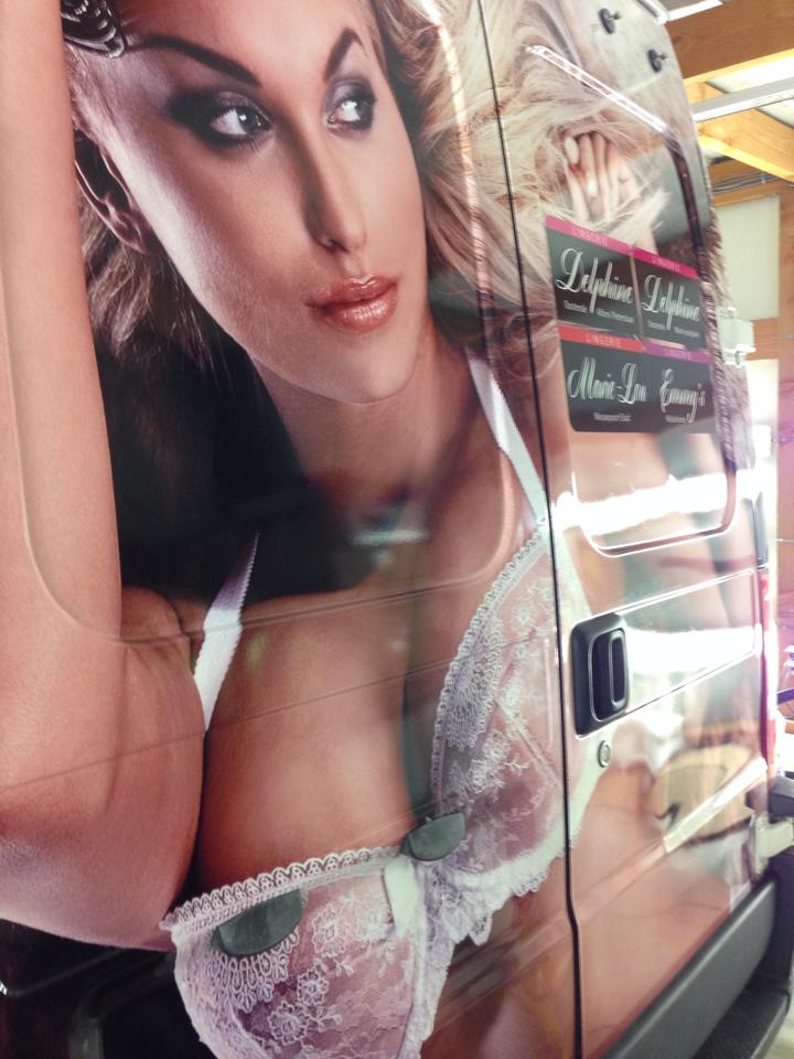

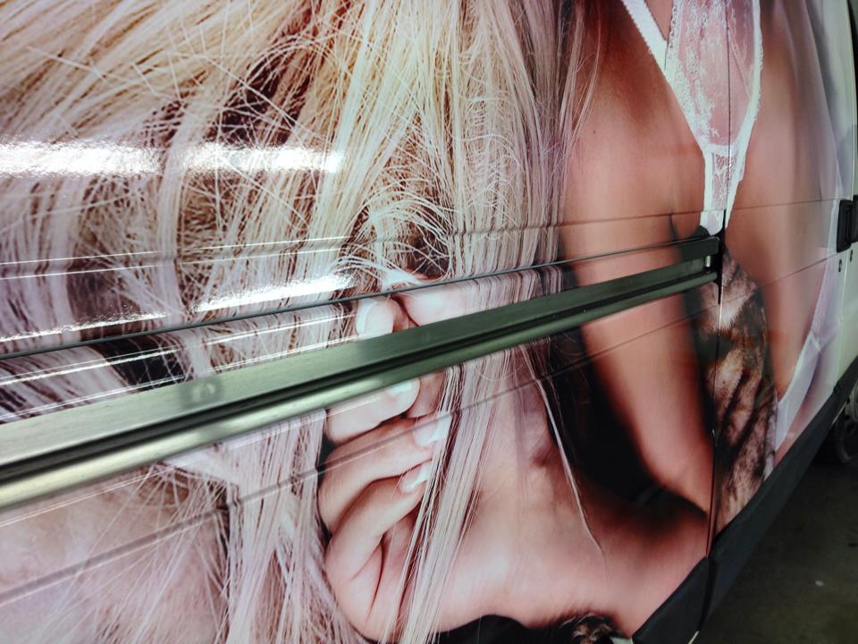

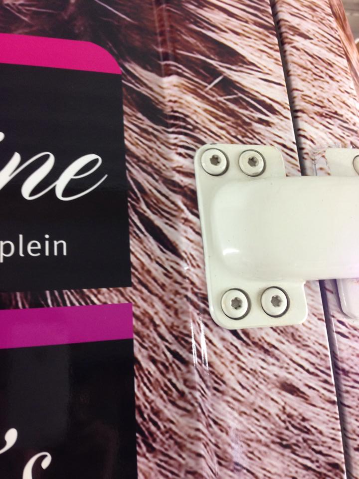

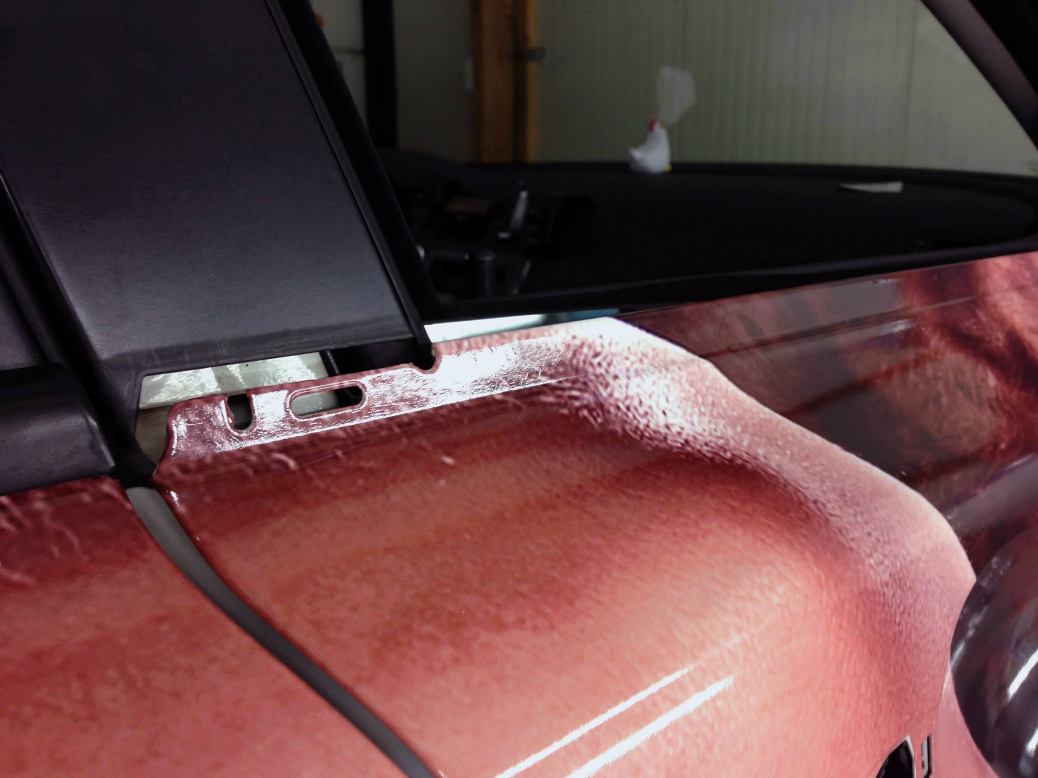

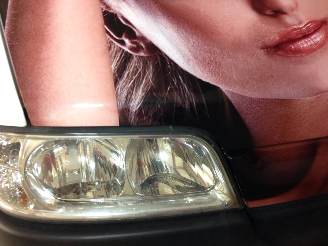

    Had a nice job last weekend, took me 10 hours work with cleaning and removing doorhandles.
    Surface cleaning with 3M Surface preparation and then cleaning with Image Perfect surface cleaner.
    Vinyl: 3M Controltac + gloss laminate for the Volvo
    Peugeot Boxer is Hexis material, applies well, but not that ‘stretchable’ when heating like the 3M!
