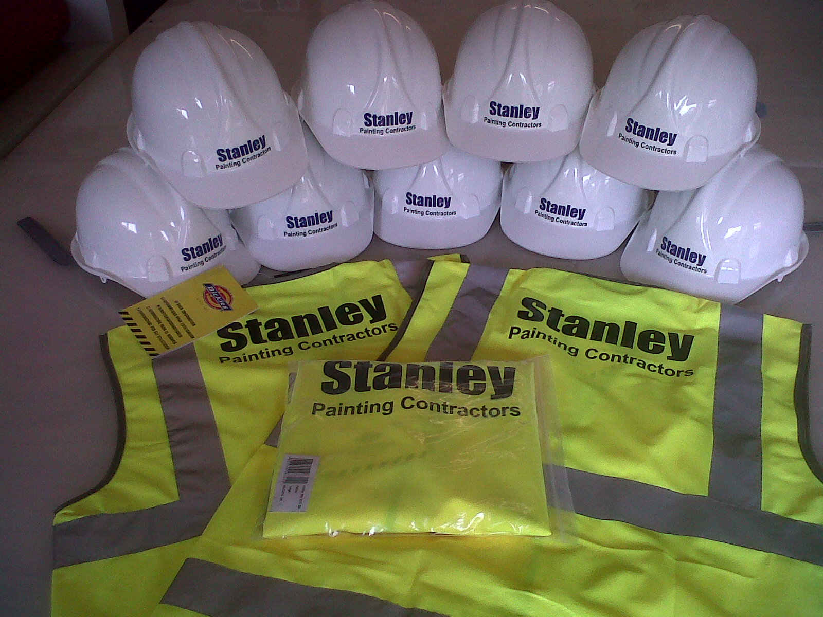

    I know what you say John, but I leave it up to the client to decide usually. I get them so sign off, agreeing that I accept no responsibility, and go from there. Seriously though, it is just a legal requirement, and I doubt any modern adhesive will damage the helmet. 20 years ago maybe, but I doubt any good quality material will fall into that category.
  • David Bilton
    15 September 2011 at 10:21
    My customer spoke to the hard manufacturer (Centurion) and they say that labels made using a Fascal product are approved for use with their helmets. I am waiting for a spec sheet to be emailed to me, but I suspect that it will be Fascal Supertack which has an acrylic adhesive. I have spoken to Robert Horne regarding this material and they say it is a screen print product. Has anyone had any experience of digitally printing this material?
    Another thing that Centurion mentioned, is that they are happy to test the suitability of a sticker if you send them a sample.
